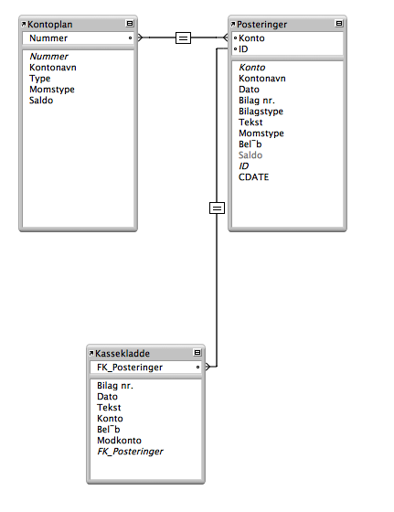

I'm trying to create a FM-script that would create a record in table A (Kassekladde), each time a person presses a button, from another layout which is based on table B (Posteringer).
Here's the relationships:

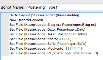

And here's the script:
Skærmbillede_2015-05-09_kl._19.53.08.th
However, it only creates the two pre-defined values "999999" and "11111111", and the rest of the fields are empty..
I've tried a lot of different things, like using a global field as the primary key, but this didnt work as well.

However, it only creates the two pre-defined values "999999" and "11111111", and the rest of the fields are empty.​
That's because the new Kassekladde record is not related to any Posteringer record, and so these field references can't get any data; you need to set the foreign key, i.e.
Set Variable [ $posteringerID ; Posteringer::ID ]
Go to Layout [ Kassekladde ( Kassekladde) ]
New Record/Request
Set Field [ Klassekladde:FK_posteringer ; $posteringerID ]
etc.
Note that it only makes sense to create the same fields in Kassekladde if you want to change their values, or capture a “snapshot in time” of these data in Posteringer (since they will change); otherwise, you can always access and display the related “original” fields in Posteringer.

It looks like all the fields with the exception of ModKonto already exist in the related table. What have the data exist in two places?

​Thanks! That worked perfectly! I havent been using the set variable function in a script yet, so today i've learnt something new  ^_^

​The reason is that I want that, is because the "Kontokladde" table us purely for exporting 5 fields in a CSV-file for an online accounting-api that I use.. So I wanted all the raw data in "Posteringer" and all of the transactions in "Kontokladde" ready for export.. Hope that makes sense..
​No, I am afraid it doesn't. Normally, you export data from existing tables, and there should be no need to duplicate it just to export it. Moreover, if there ever was such need (in some imaginary scenario), then the duplication should be handled by the exporting script, and not depend on someone remembering to press a button. Finally, when you have  a script that creates a duplicate "each time a person presses a button" you run the risk of that person (or another one) pressing that button again (and again). That's just not a good method, in any scenario.
