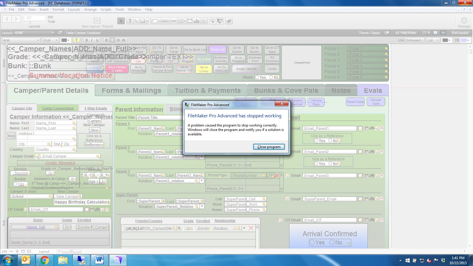

Hello All - I'm late to this party but wanted to share my experience with a recent corrupt layout - that I corrupted.  Basically I have a hosted file (Server Advanced 14) with a HOME layout that has evolved since FMP 5.  We are all now on 14.   I started adding a few Popovers to the HOME layout when 13 was launched (I really like Popovers).
Last week, in a bit of haste I launched Filemaker on another users machine and did a quick font size change to one text box in the HOME layout - literally a 10 second dev.  My mistake was I launched FMPA 12.xx   which did not recognize the Popovers and probably didn't know how to render them.  A few days ago we noticed that the Popovers were not working and as soon as I tried to do anything in Layout mode (FMPA 14) -  Filemaker crashed.   I tried to Recover the file - everything checked out.  I couldn't delete, move or edit the popovers or anything the Popovers were interacting with (Tabs in my case).  I could delete all other objects on the layout - just nothing the popovers were associated with.  All the other layouts in my file were fine and worked as they should.  I could delete the corrupt layout BUT it would break the hundreds of script steps that reference the HOME layout in my file.  My file is massive (3.2 gigs) with a couple hundred Tables and we were looking at pulling a non-corrupt backup and shutting down for about two days while we imported our data into the non-corrupt file.  It was looking pretty ugly.
In a last ditch effort I went back to the machine with FMPA 12, opened the file and was able to delete the corrupt Popovers - and then everything went back to working as it should...
I know this isn't Best Practices but so far all is good.  I have saved the non-corrupt backup file so if I run into problems down the road I can still go to the import option.  Also I have set the File to option to 13.0 and higher only.
I found this tread when looking for solutions last week and thought I would add my experience and maybe save someone a trip to the psychiatrist - it may be temporary but I will report back if further corruption is found.
