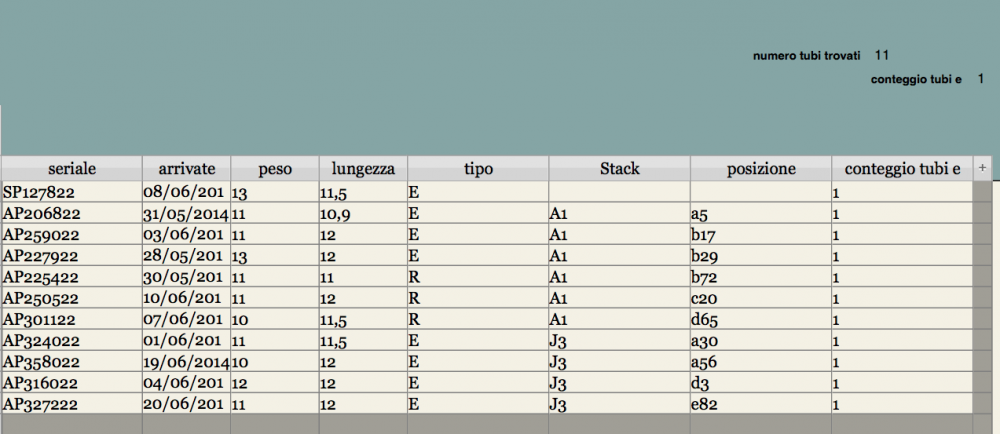

Hi everybody, please I need tips to solve this problem :(
in the table you can see the partial result of search operation operated on "serial" field.
 I need to have partial count in the field "tipo" for each "E", "R" "N" type, how many they are?
I tried relation, i tried to count partial, but i not solve it out.
please can anybody suggest me out to fix?
The simplest way is to use a summary field defined as Count of [Seriale] (or any other field that cannot be empty). Sort the records by Tipo, and show the counts in a sub-summary part.
thanks for answer, but i need to see on the top "how many type "E" have been found .
what I  am not able to do is to count how many  "E" in the field Tipo   ( search by serial I.e. )

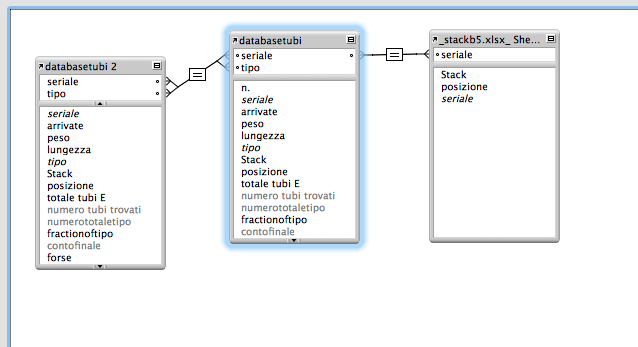

thanks for your answer, maybe can help, but i m not able to apply sorry, can explain me hot to insert this function in the field? keep on receive error " no field"
Here is a sample file.  You will need to define a "Custom Function". Look at the ONLINE HELP for instructions on how to do that.

Since you are on FMP13 (according to your profile), here is revised version of my sample file (that does not use the custom_list () custom function. It uses the ListOf type for a summary field.
Hopefully you can get this working.
dwdcSample2.fmp12
you are the man, it works great even on my file, i m studying what u wrote, i want too learn... thanks so much !
