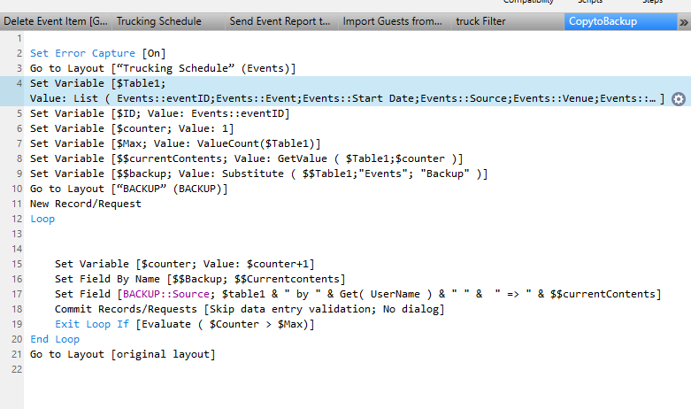

I still need script portion that will Get the field data from the List C (Which is all the fields I want to copy from ) Table A to Table B.
before I could use get activefieldcontent but that isn't going to work anymore.
please post your script and query. What is in "List C" at this point? If you made a query that returns "many fields" all values are in a delimited list in a TEXT FIELD. You cannot take that list 'as is' without parsing to push the values into somewhere else. Perhaps that's the 'disconnect'?
I suggest you get the FileMaker Training Series - Advanced to see how they take a query and push it into a "Virtual List" temporary table. from there you can push into your "real table". Or study it enough to know how to get the values directly into your other table.
beverly

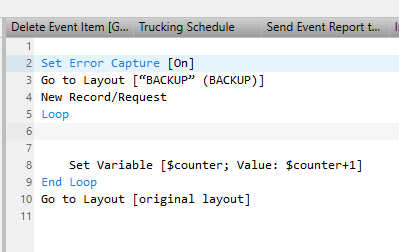

I've got the virtual table setup... but i'm somehow just not seeing how to turn the properly bult fields into the right loop structure to automate the data. I am getting lost on how to translate The fields in my table to useful information. I want the script to Grab the variable (now located in Virtual list utility (fields) under (events) and copy that field to BACKUP.)
commands like Getfield and getfieldname Just do not want to work here.
I am guessing I am missing a Set field by name, go to next field, loop, and deleted my previous attempts. how should i write this ?
I tend to use variables. Loop the records to "push" and set variables. Go to the layout where they are to added (new window), create new record, add from the variables, close window go back to the original layout, next record (repeat)... end loop.
