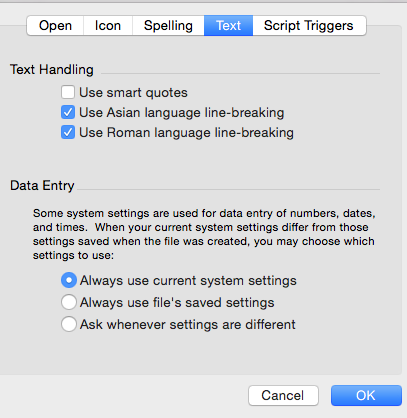

Some things are missing from your description:
  1. What do you have selected under File > File Options… > Text?
  2. You keep talking about a script, but you show us a calculation field (at least that's what it looks like).

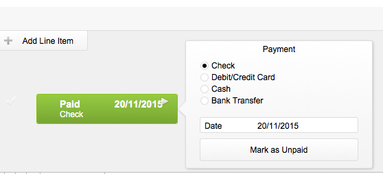

This is it from the Starter solution which I borrowed showing UK date in the screenshot below.
Case    (
    IsEmpty ( Method ) ; "Set Payment Status" ;
    $$PLATFORM = "Desktop" ; TextStyleAdd ( Status & "    " & Date Payment ; Bold )  & ¶ & TextSize ( Method ; 12 ) ;
    Status & "    " & Date Payment & ¶ & TextSize ( "    " & Method ; 16 )

I attach screenshots from Starter and File options for help .
