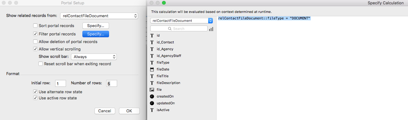

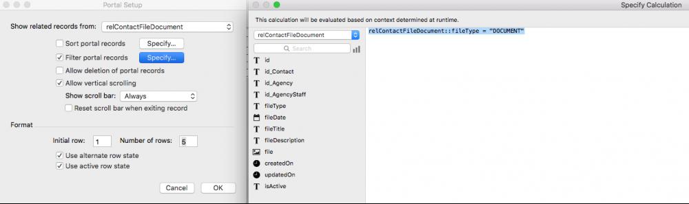

I'm not sure I'm following I guess. By "hardwire" the portal design, are you referring to your previous comment regarding the filtering of records? I've done that I believe (see attached screenshot). Which works great for getting files out of the database, however, I'm not sure how to "hardwire" anything within the portal setup that would take care of adding files to the database. Likely my inexperience with FM showing through here, but I'm just not quite following I guess.
