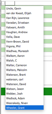

Whilst it's popped up, try typing some letters....
See attached - when I click in the pop, then when I type "Wh'
I see, however in my solution it wouldn`t let me type anything, any idea why that is?
