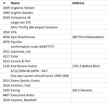

1. The file is a contact list, the top level is a name with phone number, address etc.
2. The sub levels are notes, a given top level may have no sub levels or multiple sub levels.
This is what I currently have in Excel. The # column appeared when I exported the file, it seems to be unique and is only assigned to the top item, first level.
The records without the #, are the sub-levels.
Edited by laguna92651
If you want to do this in Filemaker, import the sheet into a temp table (or convert it into a new file), rename the # field to PK, and add a new field named FK. Then have a script loop over all records and do something like:

Okay, let me try describe this step by step.
First, create these fields in the Customers and Notes tables (in addition to the data fields);
  • Customers::CustomerID_pk - Number, Auto-enter serial number;
  • Customers:PK - Number;
  • Notes::Customer_fk - Number
  • Notes::FK - Number
Now, after having imported the Excel into a Temp table, and running the script to assign the appropriate FK (not PK, as your post says) value to all the sub-items, do this (you can script this if you want, but since you only need to do this once, I'll assume you're doing it manually):
1. In the Temp table, enter Find mode, type * into the PK field, and perform find. Now you should have a found set of "items" (i.e. customers) only.
2. Go to the Customers table. If necessary, show all records and delete them. Select File > Import Records. Import records from the Temp table. Map the Temp::PK field to import into Customers::PK (do not import the FK field). When asked, select to perform auto-enter options during the import.
3. Go to the Temp table, and select Records > Show Omitted Only. Now you should have a found set of "sub-items" (i.e. notes) only.
4. Go to the Notes table. If necessary, show all records and delete them. Select File > Import Records. Import records from the Temp table. Map the Temp::FK field to import into Notes::FK (do not import the PK field).
5. Define this relationship:
    Customers::PK = Notes::FK
6. Return to the Notes table. Click into the Notes::Customer_fk field and select Records > Replace Field Contents… > Replace with calculated result. Enter Customers::CustomerID_pk as the formula.
7. Change the relationship to:
    Customers::CustomerID_pk = Notes::Customer_fk
8. You should now be able to delete the Customers:PK and Notes::FK fields.
