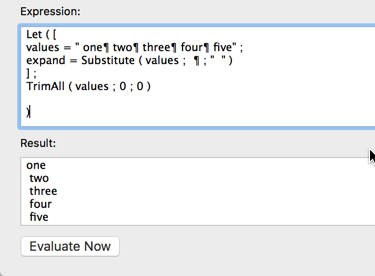

  4. I originally started to write this and tested it using TrimAll() (please see screenshot).  The results are no different than Trim() so we can use Trim() instead.
As you say, this was untested but it certainly works and it amazes me that you can put it together without testing!
Regardless, I ran yours through 400+ records and it is perfect (no surprise).  Thank you so much for assisting me in learning better approaches and ways of thinking.  I really appreciate it!
Oh wait. :|  You used TrimAll() in case there were other spaces between.  Right?  My bad!  I shall use TrimAll()!!

I used TrimAll() in case you happen to have a value followed (or led) by two or more spaces. The Substitute() handles only one leading and one trailing space.
