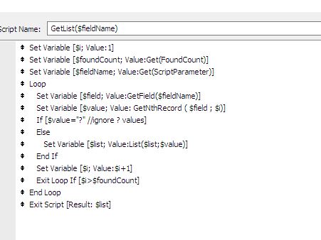

Can you screenshot the script? This works correctly for me

See Attached Image
I think your problem is in the way you are creating the list - am I correct in assuming you actually want a list of values from the found set for field $fieldname?
Yea, I am trying to create a list of values from the found set. $value always seems to return the value from the field in the active record, not the Nth record.
I've tried the custom functions and they don't seem to work correctly for me.
I wrote an alternative script that goes to each individual record with GTR to build my list. That works.
The problem with your script is the way you use the $field variable. Instead of :
GetNthRecord ( $field ; $i )
do directly:
GetNthRecord ( GetField ( Get ( ScriptParameter ) ) ; $i )
@comment That worked! Why would that make a difference?
ALSO, this only works on values for the active table. If I try for a child table, I don't get any values.

I wish I could give you a logical explanation, but I can't. It's a quirk stemming from the built-in confusion between field name (as text), a reference to a field, and a reference to the field's value.
