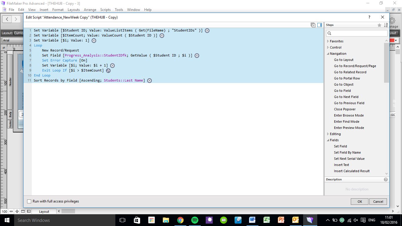

I have a script that populates a table with StudentID based on a value list I created. This works fine when creating new records. Such as for a new weeks register. I click a button and it populates the table with a new week and all the pupils are added.
Now I want the same script to function in a different table but I don't want it to add all the pupils every time. I only want it to add new pupils. So I need a step in the script that checks the table first to find records that already exist and then add only the records from the value list that are not in the table.
A picture of my script is attached
Thank you for any help.
Hi Joe,
Strategy: you first want to reduce the list then run your script.
Create two ValueLists - one of the existing Students, one of the one's you want to add. Let's call them listA and listB.
Create a custom Function (Assume you are using FileMaker Pro Advanced):
Quote
NotList (listA ; listB )
// returns List with Items in A not in B
If (listA <>"";
     If(PatternCount("¶"&listB&"¶"; "¶"&LeftValues(listA;1)); "";LeftValues(listA;1))
 &    NotList(MiddleValues(listA;2;ValueCount(listA)-1); listB)
Now pass the two lists from a script or Formula field to the Custom function to get the reduced list.
Now you can run your script.
lists.fmp12
Edited by Aurigo
If you set the StudentIDfk field in the target table to validate as Unique, Validate Always, you could then simply import the records from the Students table. This would skip all existing values and create new records only for the remaining ones. A similar result can be achieved by selecting "Update matching records in the file" + " Add remaining data as new records" for the import.

For a task that requires a script to run anyway, I would prefer to put all the required logic into the script and not branch some parts out to a custom function.

I have tried Aurigo's way and i can get the lists to work from the existing tables and create a new list. This bit works fine but when i run my scrip based on the new created list that only has the values of StudentID's that are not already there, it adds one blank row only.
Comment, I like your method but can this be automated by a script when the layout is entered?

Yes, of course it can be automated by a script (though I am not sure you would want to run the script every time a layout is entered). See attached demo.

For completion, here's how a script comparing two value lists in a loop would look;
Go to Layout [ “Target” (Target) ]
Set Variable [ $sourceIDs; Value:ValueListItems ( Get (FileName) ; "SourceIDs" ) ]
Set Variable [ $targetIDs; Value:ValueListItems ( Get (FileName) ; "TargetIDs" ) ]
Set Variable [ $n; Value:ValueCount ( $sourceIDs ) ]
Loop
  Set Variable [ $i; Value:$i + 1 ]
  Exit Loop If [ $i > $n ]
  Set Variable [ $id; Value:GetValue ( $sourceIds ; $i ) ]
  If [ IsEmpty ( FilterValues ( $id ; $targetIds ) ) ]
    New Record/Request
    Set Field [ Target::SourceID; $id ]
    Commit Records/Requests
  End If
End Loop
BTW, you didn't say why you need this. It looks like what you are accomplishing here is nothing more than a duplicate of the source table. Wouldn't it be simpler to use the original for whatever purpose you have in store for the duplicate?

I have cracked it. I used Aurigo's solution eventually. The reason it didn't work was because I needed to add another instance of the 'Results' table to link it to an existing table. Now works fine.
