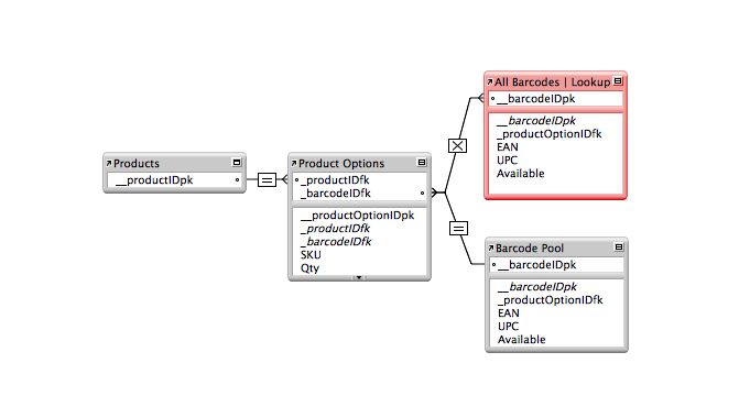

I have one more query. I have a relationship between Product Option table and the Barcode Pool. This relationship is O2M the barcodeIDpk with a lookup for the actual EAN (barcode) value on the Product Option table. When I set a barcode ID in the Product Option table - shouldn't the ProductOptionIDfk field update in the Barcode pool with the ID of the product option that the barcode is assigned to??
I am convinced I had it working earlier - but not anymore and cannot see to figure out why?
See my relationship graph below and the solution attached.
