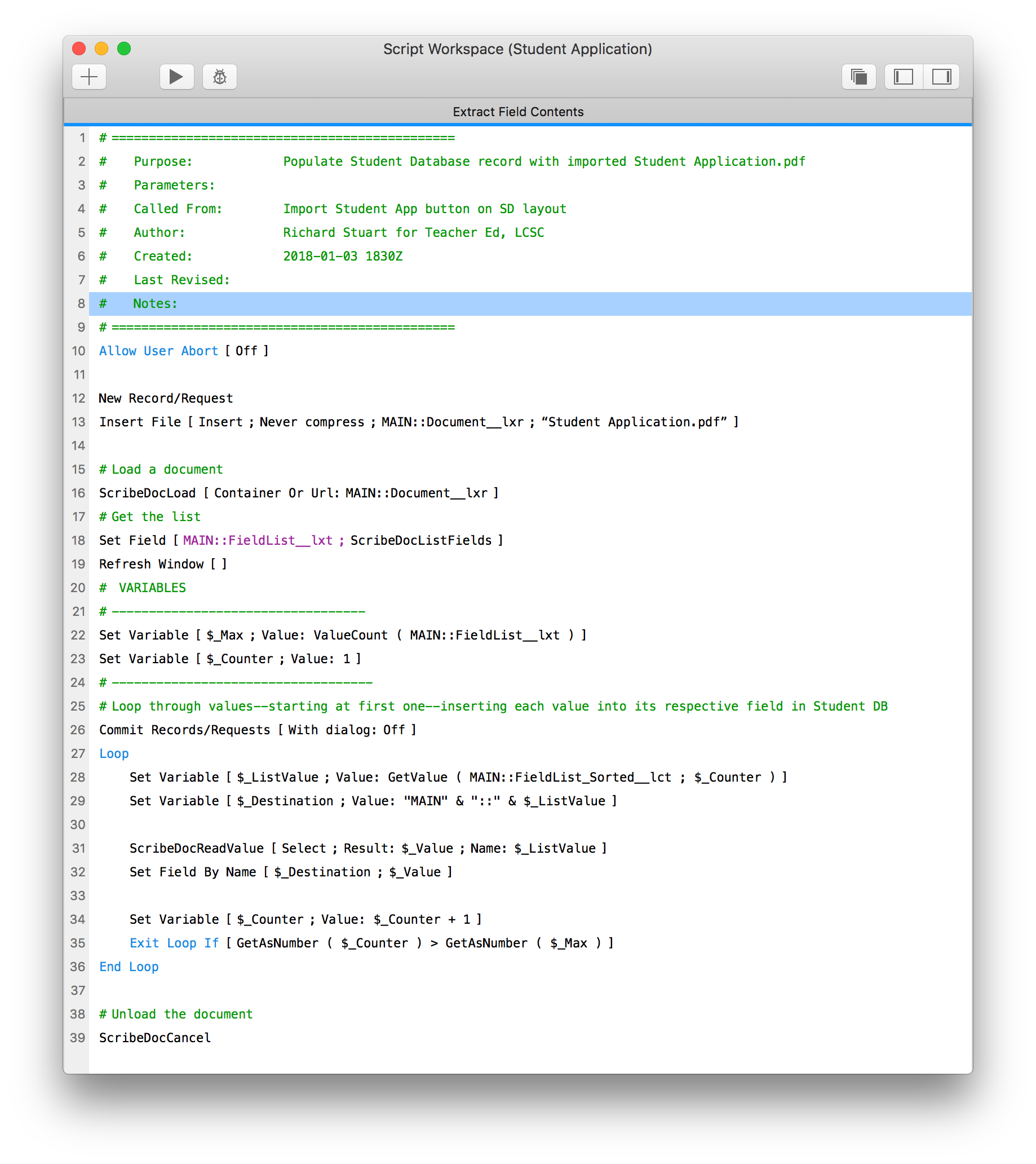

I thought I'd bump the thread to include the looping script I composed to load a .pdf, parse its fields, then populate the FileMaker Pro database.
Cheers!
Note: In line 28, I used a calculation field, FieldList_Sorted__lct, instead of FieldList__lxt, because I have so many values in the .pdf that I want to import from that I wanted the list sorted in ascending order to make it easier to troubleshoot troublesome fields (which are listed in ascending order in the FileMaker Pro's field editing screen) since Scribe imports the fields unsorted.
To convert the unsorted list into a sorted one, I made a dynamic value list out from the FieldList__lxt field then used FieldList_Sorted__lct (calculation/text/unstored, ),  defined as follows:
ValueListItems ( Get ( FileName ) ; "Values" )
...with Values being the value list name.
