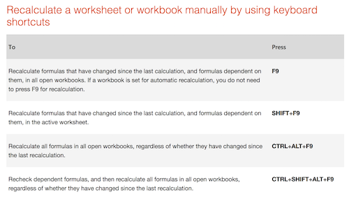

Scribe can not force Excel to recalculate formulas as all it does is write to underlying XML sheets. The recalculating of a cell is controlled by Excel. I suspect there is a setting you have set in 2007 that is not set in subsequent versions OR the functionality has just changed between versions. There are a few shortcut keys you can use to force all calculations. They are shown in the attached image from Microsofts Excel support page.

Hi Ryan,
Thank you for your prompt reply. Yes, I had the same thought at the beginning,there could be something wrong with the excel apps.
Under excel 2007 all calc goes automatic, every formula related to value which has been submitted by scribe is resulting correctly, while under 2010 or 2013, no calculation is performed.
To make some test, I type in  the number directly with keyboard (in 2010 or 2013), and the formula does work, the results presented automatically, no need to do any keyboard shortcuts as you suggest.
Therefore, I post this in forum since this looks like the plugin triggers auto-calc only in 2007 but not under 2010 or 2013.
