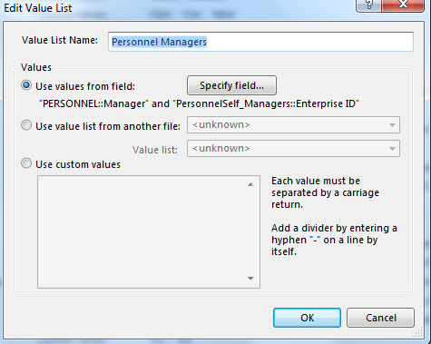

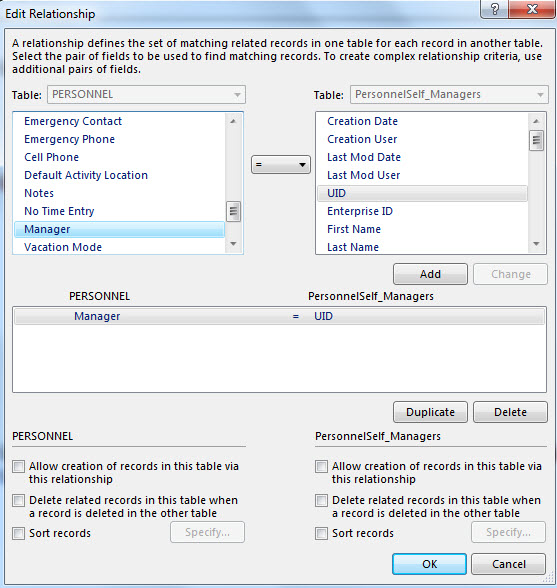

I have a value list that includes the "Personnel::UID" of all managers in my personnel table. (Determined through a self-related table where "Personnel::Manager" = "PersonnelSelf_Managers::UID". I included a screenshot of the relationship.)
I want to compare a single value ("Personnel::UID") against the contents of that value list to take action (show or hide some data on the layout) based on whether the person in question is a manager or not.

I don't understand your description. It looks like a manager is someone whose Personnel::UID value appears in the Manager field of another record of the Personnel table. If that's correct, then a value list of managers' IDs would be based directly on the Personnel::Manager field, and the relationship would not be required (for the purposes of defining this value list).
Hmm, you are correct. I described it poorly. My value list is based on Personnel::Manager, and I use the relationship to display their name, rather than an ID # in pop-up lists.

Ah, I now see that your relationship goes in the opposite direction from what I thought (i.e. it shows who the manager is, not who the subordinates are).

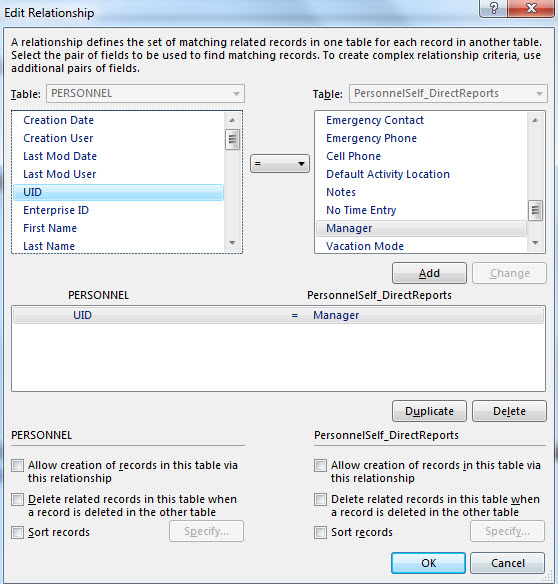

Unfortunately, for conditional formatting you cannot choose the context for evaluation. Are you sure you don't have (and don't need) a second self-join relationship of:
PERSONNEL::UID = PersonnelSelf_Subordinates::Manager
so you can show a person's subordinates in a portal?
I do, actually! I've been staring at all of this so long, I'm losing my mind.
