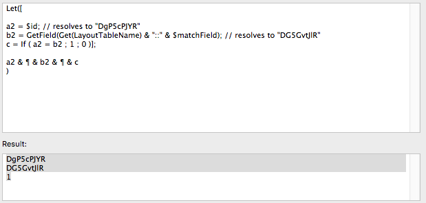

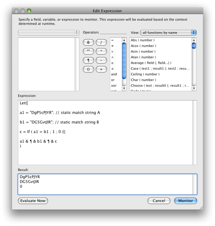

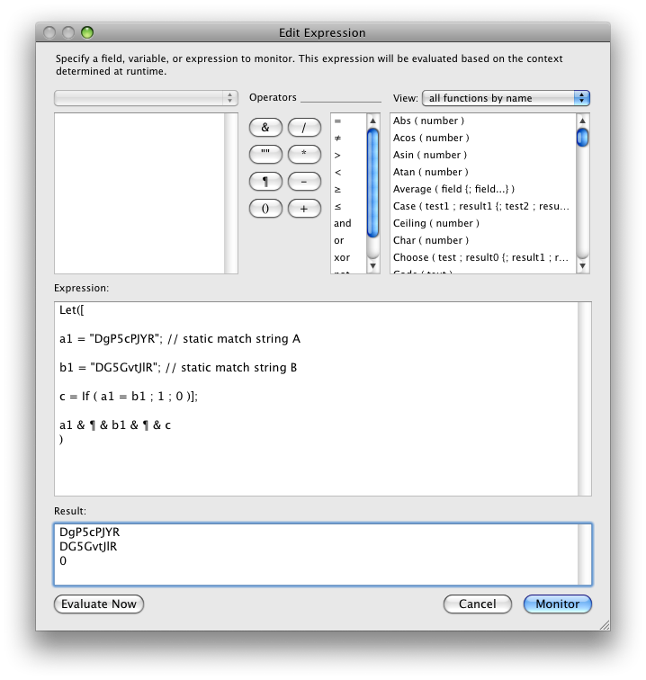

Apologies, I cleaned up the expression to post and made a typo so posted the opposite results to what I'm seeing. In fact the dynamically referenced comparison is returning true and the static false (expected result). Have attached both evaluated results below.
