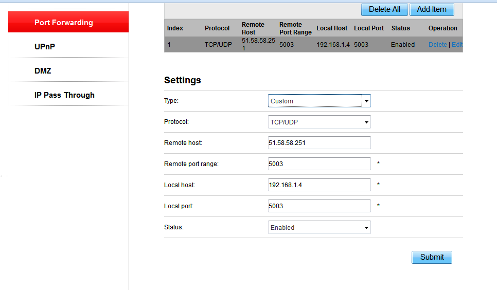

But now, I want to be able to connect from home. I have checked the forum on similar topics on Port fowarding, so I tried configuring ours , my settings are shown on the screenshot attached.
We have Static IP Address for our Router (which is shown on the screenshot), however, I can't seem to connect. I don't know where I got it wrong, though my Router's interface settings are quite different from the suggestions posted on the forum.

The port you show is 5003 which is the FMP / FM Go port.  WebDirect uses the browser to connect to the web server so that would be either port 80 or 443 if you are using https.

and Again.. based on my Router's interface, I am kinda confused.. Remote host and Local Host?
I thought I was meant to input only my server ip address.
much depends on the make and model of the router on how to set it up correctly.  I don't think you need to fill in the 'remote host' part.
Check something like portforward.com to see if they have instructions for your router.

I did the port forwarding all over again, leaving out Remote Host as suggested.. (TCP/UDP Port 5003)
