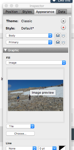

I don't have FM11 any more, but in FM14/15 you can set the body to have a 'fill' of an 'image' (as opposed to a solid colour, gradient etc). That image is not considered to be on the layout, it it just a background.
Was that around in FM11?
Great tip, thanks!

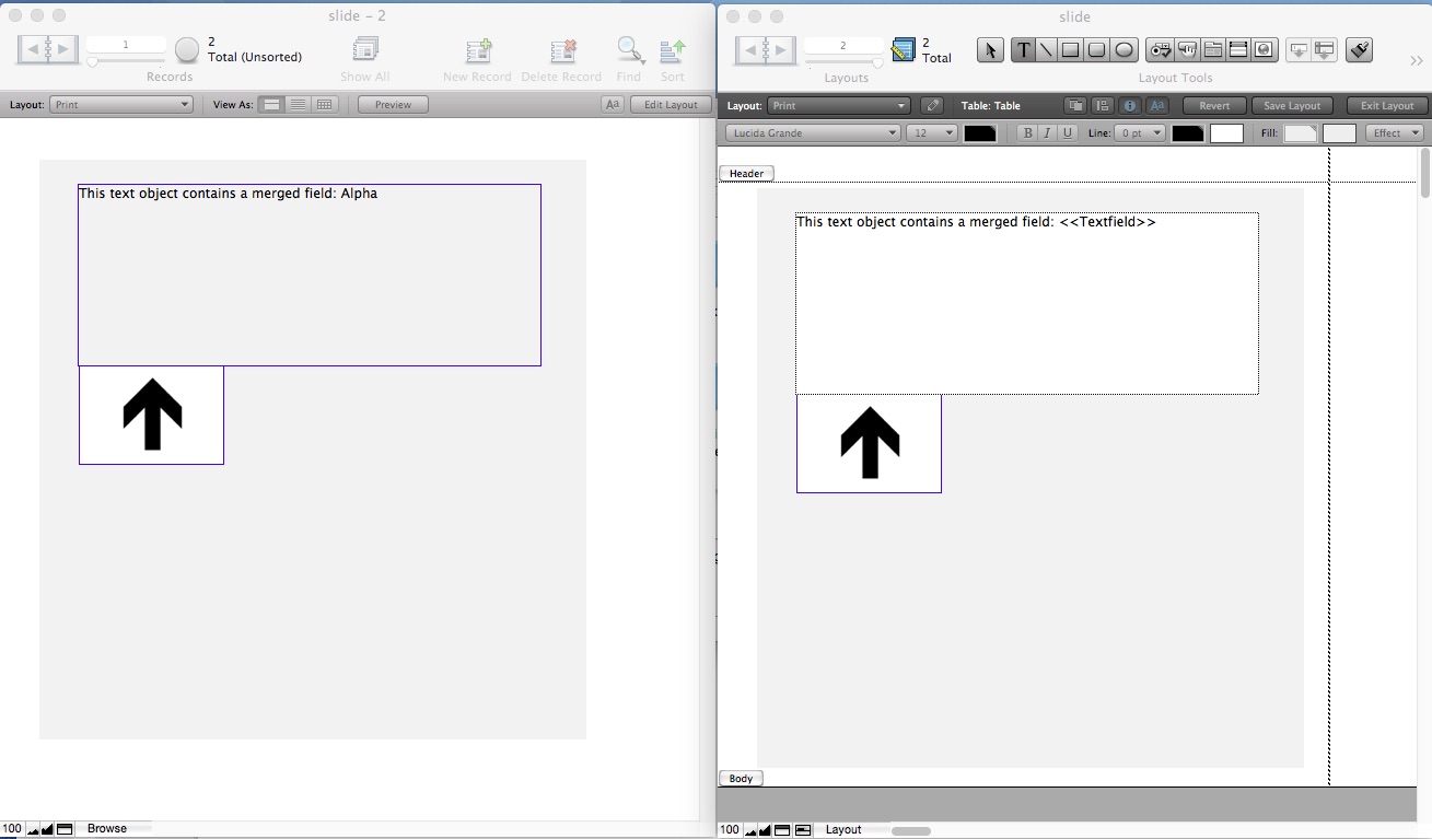

Does this work for you?
slide.fp7
It does! That's exactly what I'm looking for. So I  must be missing a setting somewhere?
I'm not sure why it doesn't work in my example file...

OK, I must be more dense than usual, but I'm not seeing any slide behavior in comment's example. That's the reason for my incorrect advice earlier; my test didn't show it either.
What have I missed?
oh! It will only show in preview mode.

I think the point you may be missing is that an object will slide up based on objects above it. An overlapping object is not above the selected object.
