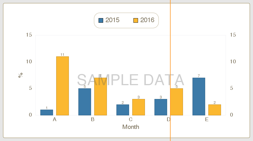

Here is the graph he would like to use.

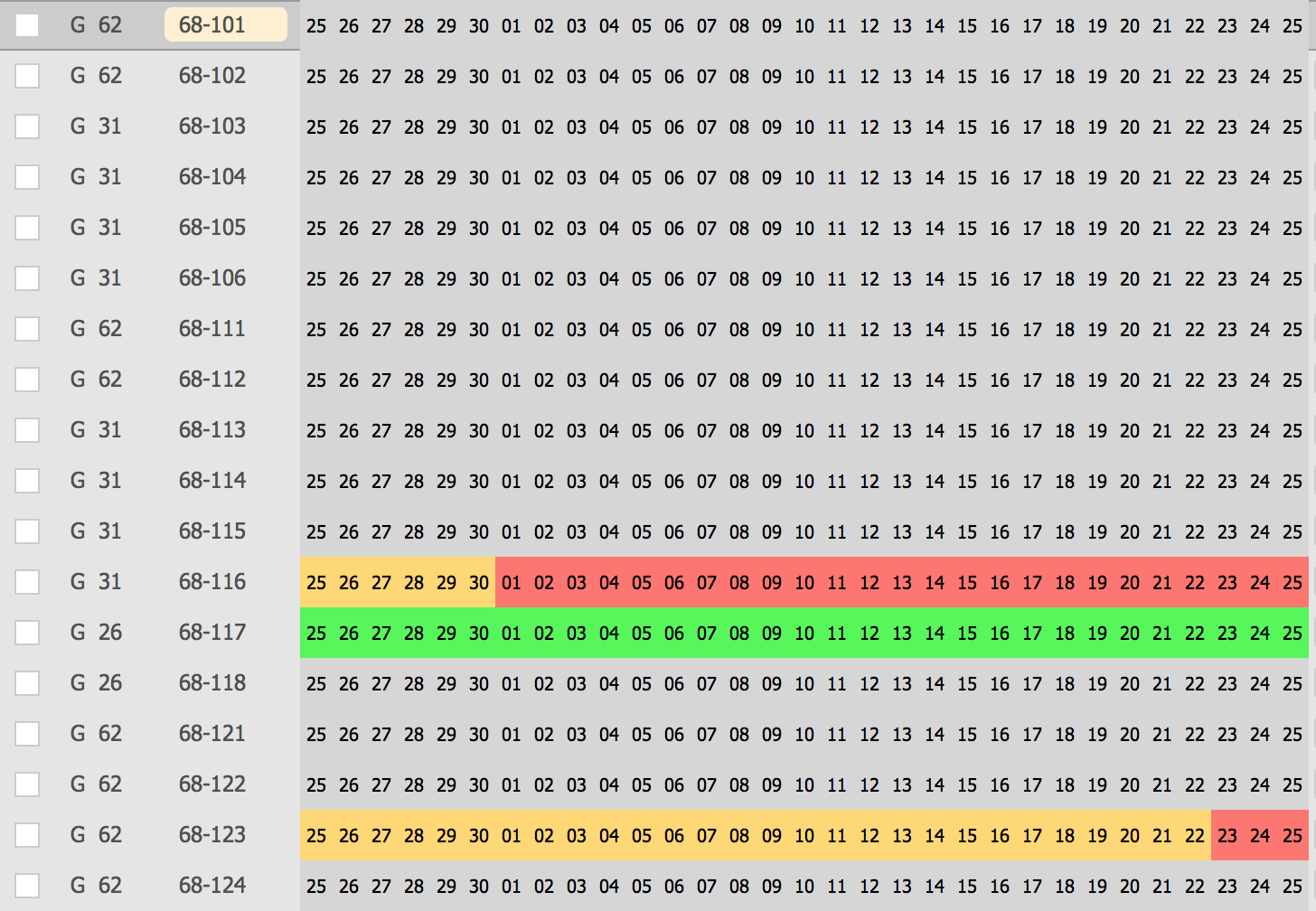

Each unit is rented by month and the customer stays until they decide to cancel their agreement.  At this point the "End Date" is populated turing the Unit availability "GREEN" to the office staff.
The owner wants to see his utilization of units rented by month looking across "Last Yr vs This Yr".
If we populate the "End Date" then the unit goes green becoming available.
Currently this "End" date is the "Demarcation" for a lot of other stuff too.
So I am trying to build a relationship to take into consideration units rented each month ; do I build 24 relationships ? and then the units that become available need to be "NOT" considered.
I am not trying to be confusing, it is just that this "End Date" if empty the relationship fails with the units rented.  It throws off the calculation.

The customer would like to graph each month his units that are rented as a percentage of his overall units, currently he has 87 and he would like to see Last year vs this year in one graph.  I've posted the graph that the customer chose since it provide two columns and he would like these two columns to represent ea month ( last years and this years ).

The graph in your file is exactly what the customer is asking for visually.
