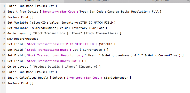

Hi
Please can some one help me with a bit of scripting:
Im using the sample Inventory database that I have added a QR code for each Stock item. Ive then added a  button on my iphone layout that runs my attached script and adds a transaction record and enters 1 in the Units OUT field. This works ok when removing just one stock Item but not when removing 5 or 6 or adding 20 or 30 I have a problem.
Im not sure if this is the best course of action but I now have two different QR codes per item that either has IN_0000123 or OUT_0000123. If Im removing a stock item I would like to scan the OUT code and this then searches for the record and then gives me a option to create a transaction and enter a figure of items removed. The same with the IN code but this would add a figure in the Units IN field. Just need a bit of help on the script or if you can think of a better way.

When you go to the "Product Details | iPhone" layout at the end, you don't have to perform a find. Presuming that layout is based on the same table occurrence as where the script started, it should still be on the same record.
What problem do you run into when dealing with several stock items at a time?

the problems I found with just having my script reducing the total stock level by one every time a user scans a code is sometimes they might want to reduce the amount by up to 6 or if stock is being added then we can have 50+ items added at one time.
ive now changed the script to forward to a layout with a in and out field so they can enter a amount this seems to work better.
