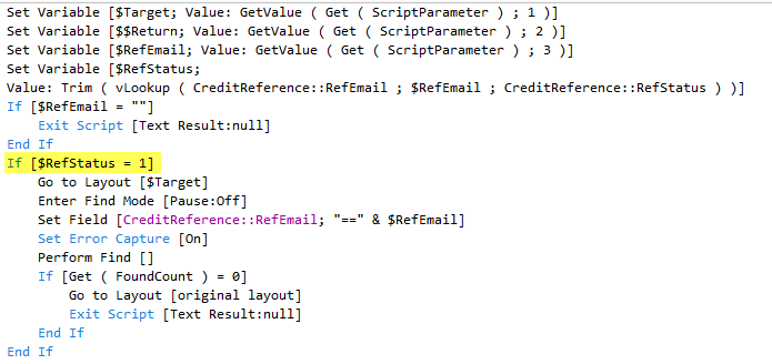

I have rewritten this code several different ways but the if statement will not recognize the value in $RefStatus.  What am I missing?

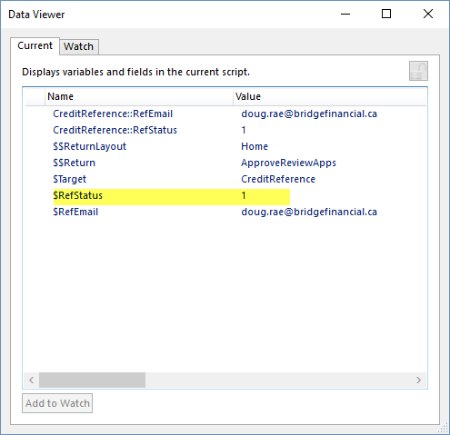

Even though the Data Viewer shows that the value of $RefStatus = 1, the statement evaluates as false.

Did you debug it and when it goes to that step it skips it or does your script bail before it gets there?
Your script/script step may be corrupted, too.
Have you tried playing around and saying if 1 = 1? That's usually a good test.
When I debug it, it skips the step.  If I use a different test, no problem.
I also tried deleting the IF statement and recreating, still same result.

We cannot answer that, because we don't know (a) what the function vLookup() does, and (b) what are the contents of the parameters supplied to the function.
Note that it's enough for the variable to contain a trailing space in order to be not equal to 1 (assuming it's defined as text).
Issue Resolved:  the vlookup function was causing a problem.  Vlookup was posted on the Brian Dunning site and works great with text results, but seems to have issues with numeric values.  Thanks for the feedback.
You could try wrapping it around with GetAsNumber.
Yes.
If [ getAsNumber( $refstatus) = 1 ]
Thanks Agnes,  I passed the value as a parameter to the script and removed the vlookup function.  That resolved the issue.
