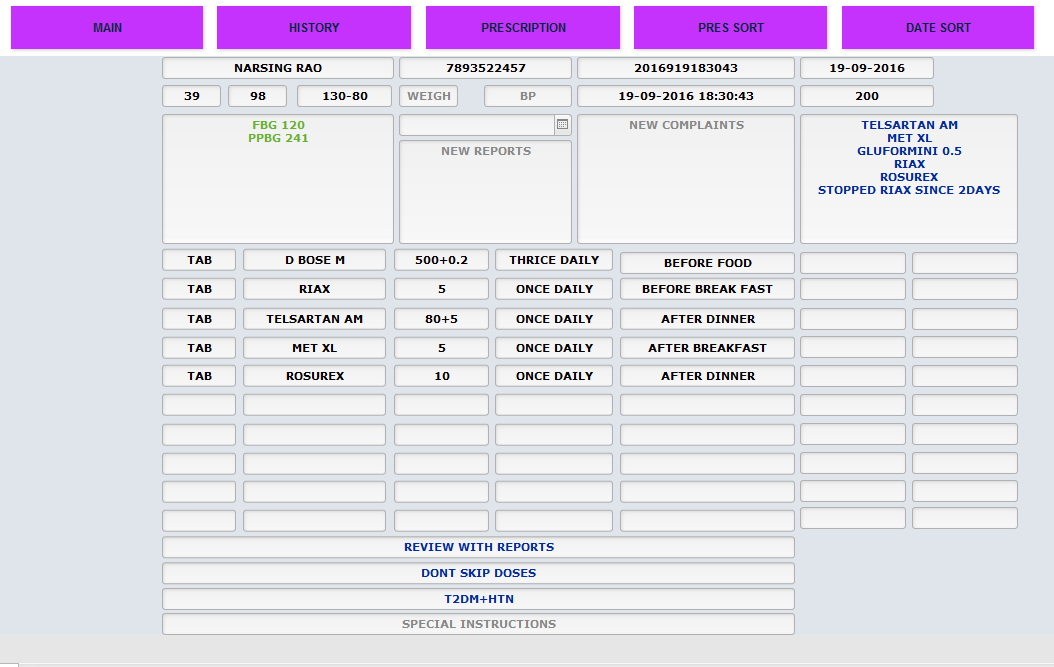

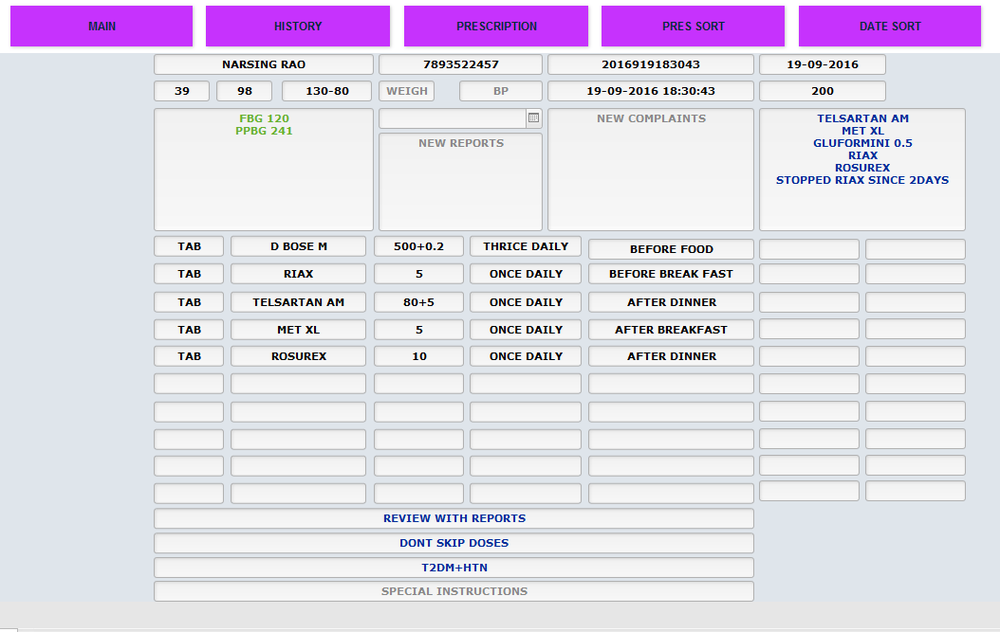

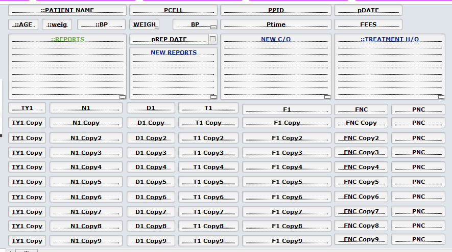

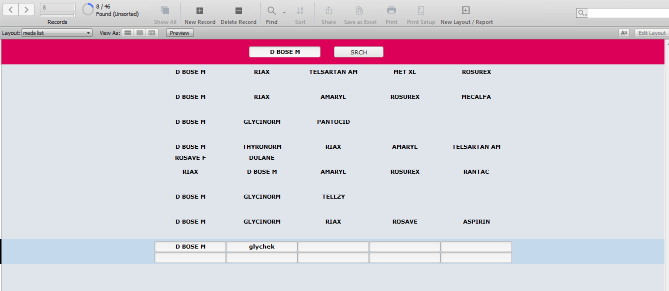

i am a doctor making clinical management solution for my own usage
below are browse mode and layout mode pics
dialy i see many patient but want to find out what drugs are used mostly by me
N1, N1COPY , N1COPY2 ETC ARE DRUG NAMES FIELDS
CAN ANYONE HELP ME TO SCRIPT SO THAT WHEN I TYPE DRUG NAME IT SHOULD SEARC ALL N1 COPY TO N1 COPY9 FILEDS AND SHOW ME THE RESULT PLEASE EXPERTS PLEASE

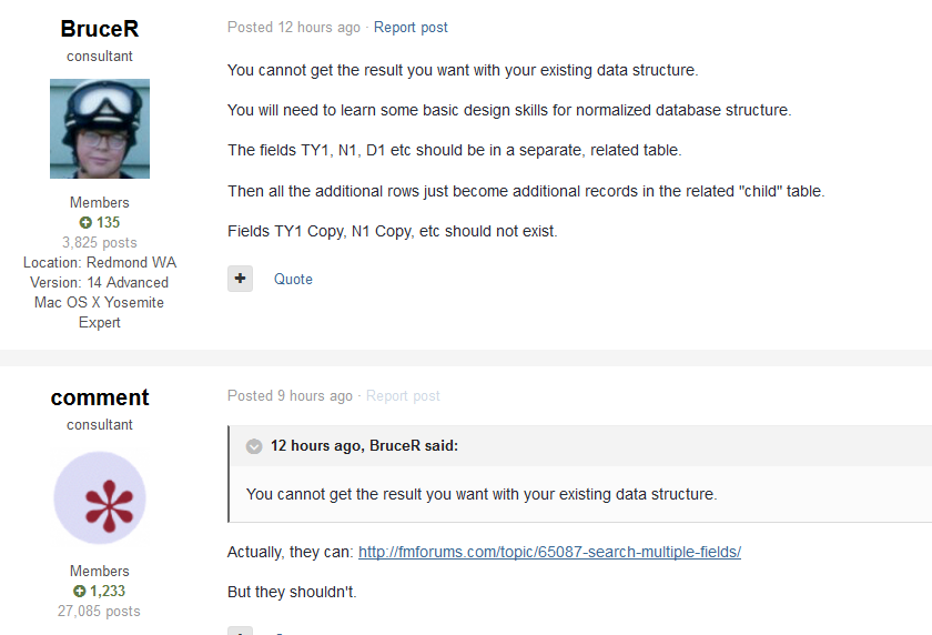

You cannot get the result you want with your existing data structure.
You will need to learn some basic design skills for normalized database structure.
The fields TY1, N1, D1 etc should be in a separate, related table.
Then all the additional rows just become additional records in the related "child" table.
Fields TY1 Copy, N1 Copy, etc should not exist.

6 hours ago, comment said:
Actually, they can: http://fmforums.com/topic/65087-search-multiple-fields/
But they shouldn't.

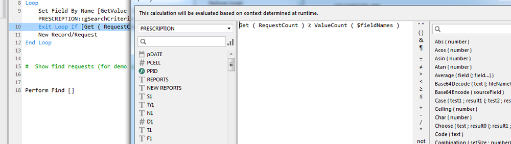

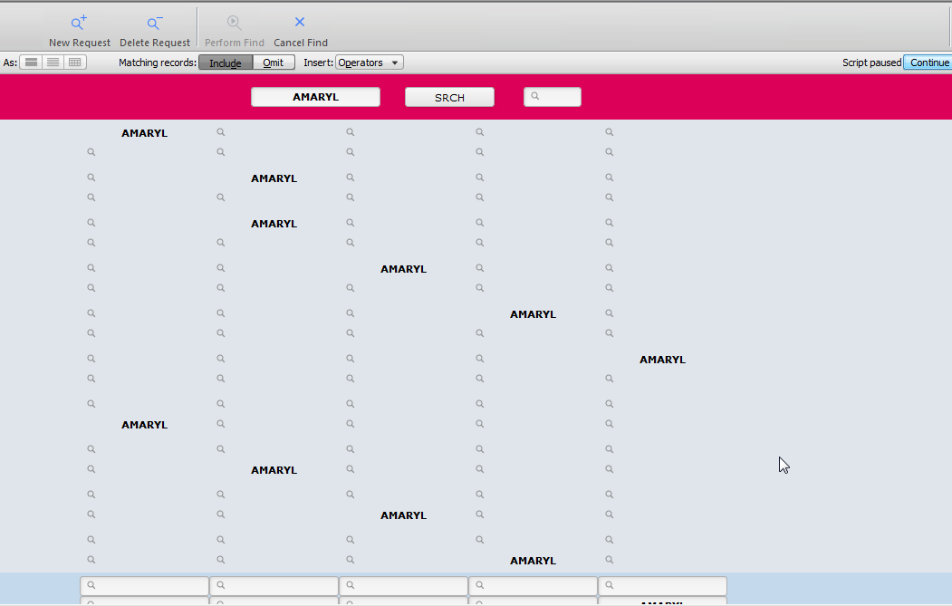

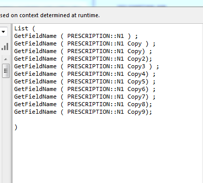

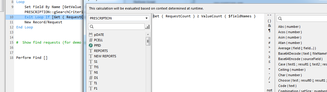

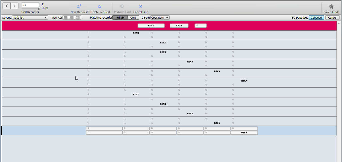

i have one request sir i just want theres a step in ur example file i removed it pause/resume script indefinitely
and i want the fileds where my g search criteria is there and gets filled with predefined color is it possible ??? please help
added new pic but script is paused hope its not there and shows result ??

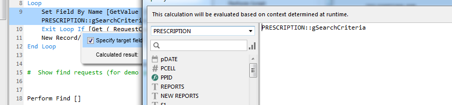

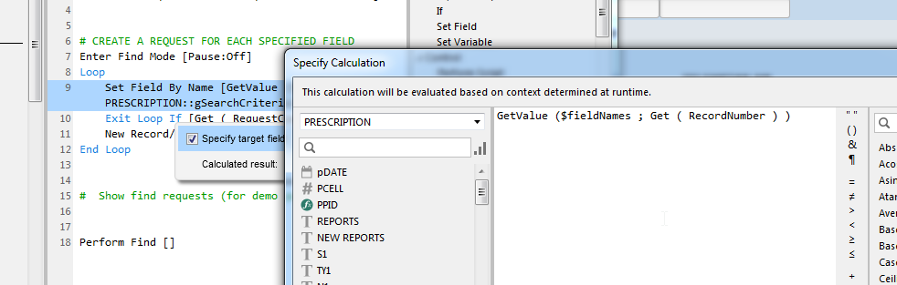

i modified script as below but when i searching a medication instead of showing only that word showing entire record data as see above  ??
That's how Filemaker's search works: it finds records. To get what you want, you will need to change your structure so that each prescribed item is a separate record. You probably should have a structure similar to an invoicing solution:
Patients (Customers) -< Prescriptions (Invoices) -< Dosages (LineItems) >- Drugs (Products)

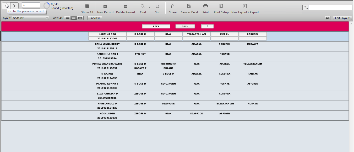

1st pic is before script pause showing 11 and script continue showing 9 records sir ???? confused :(
but in ur example file before and after showing 4 ??
"dialy i see many patient but want to find out what drugs are used mostly by me"
You CANNOT do that with your existing structure.

Sorry, I don't follow. You say you have changed my script, so if you're getting different results, it's only to be expected.
Anyway, I would advise you to focus on restructuring your data as suggested, because even if you manage to solve this issue somehow, you will run into many others - all caused by your inadequate data model.

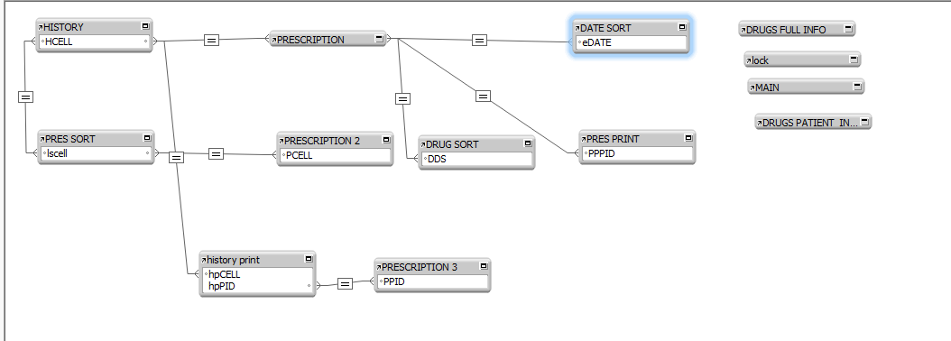

I cannot access your file.  Why not post a screen shot of your graph?  We can tell from that if you are restructuring as needed and as suggested by Comment and BruceR.  :-)

I need to see if you are making the relational changes suggested.  If not then it does me no good to get into your file anyway.  I cannot help you if you have improper structure or if you are not at least moving that direction. Are you ignoring what has been said about your structure?  Have you even reviewed the link provided?

suggestions of fmforums wat m concerned the most few yrs ago u helped now m in this stage made my own solutions u dont remember me , but i am since couple of yrs
perfectly running without any hassle "comment" completed the final step :)
Oh, I do remember you.  I am giving you benefit of the doubt and trying to again steer you onto correct path but it seems you have not listened ... then or now.  Your graph does not show the fields in the tables.  I want to see your fields.  I want to see if your fields are still named with numbers after them.
I again repeat the suggestions made by other professional developers.
