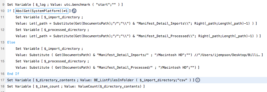

I'm using
Let(_path = Substitute(Get(DocumentsPath);"/";"\\") & "Manifest_Detail_Imports\\";
Right(_path;Length(_path)-1)
then BE_ListFilesInFolder ( $_import_directory;"csv" ) to list the contents of the directory
to read the contents of \Documents\Manifest_Detail_Imports on my server
doing it server-side is massively faster and less troublesome than using a client to run imports.
