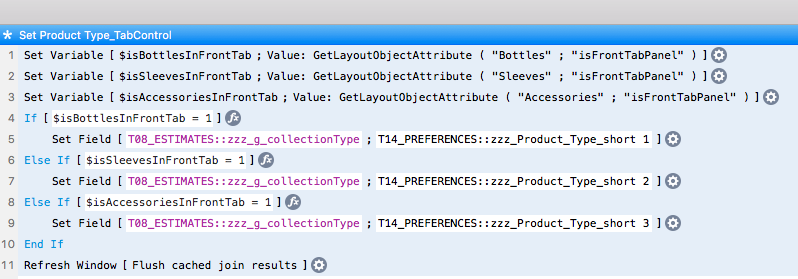

I have a tab control panel with four tabs, and I would like to achieve that when I change tabs a script is triggered and would set the value of a global field called "zzz_g_collection_type" according to the tab name which is active.
I need this field to dynamically filter the products that are shown on 1_row portals that I have put into each tab panel space.
I have followed Elishree Dey tip on http://burnignorance.com/filemaker-pro-tips/trigger-a-script-when-user-changes-the-tabs-in-filemaker/ but I cant make it work, it only changes the value of "collection_type" field once and only to show that the first condition is not met.
I have attached the picture of my script.

Morever, I have set an Object name to each tab Control so it would work, and also the desired value for zzz_g_collection_type comes from another related table with only one record that I use as preferences, this is on Preferences Table I have three fields called "Product_Type_Short_#" and those match on Elishree Day script tutorial.
Any ideas what I could be doing wrong?

You have FileMaker Advanced. Have you tried stepping through it with the script debugger?

Many thanks for your tip. I am still quite new to filemaker scripting, and dont understand very well your suggestion. Could you please guide me a little be more about where to put the function within my script? I put it instead of  If ( $isBottlesInFronTab = 1 ) but it is not working... any further ideas?

When asking for help it is very important to give enough information to make the helper's job easier. Saying "I tried something and it didn't work"; well; doesn't work. Better to post a complete copy of your script; or your file; or a simplified version of your file which you have gone to the effort to construct in order to demonstrate the problem.

So... what do you see when you step through with the debugger? Do the variables get set as expected? Do the tab names match your script?
