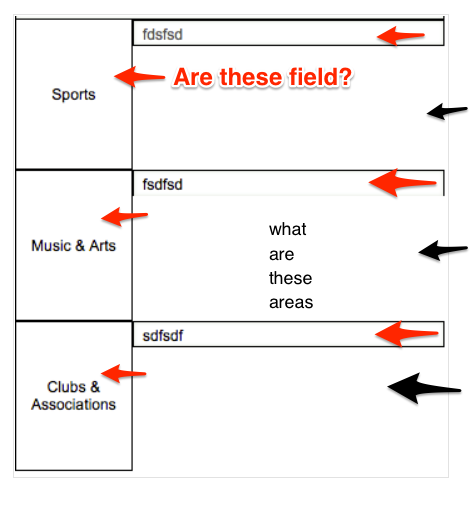

Can you show a screen shot of the layout, not quite sure what you mean by the border? It almost sounds like you have a field in a board?

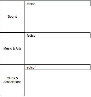

Like this, could i fix the border?
I am looking at your enclosure and see boarders and what appear to be fields.
It might help to know what the areas are, and comment on the black lines as to wherther or not they are boarders on the fields, or boxes you have drawn?
also, what view are we seeing, Form, Layout, Preview, or a sketch?
Edited by Lee Smith
Sorry for unclear description. "Sports", "Music and Arts" and "Clubs and association" are text box, not fields.
the one with fdsfds, fsdfsdf and fdsfsd are text fields. The space below the text field is just white space because the text length in field is short. so the field automatically shrink in order to fit the text length. so my question could i fix the border of text field?
The picture i took is in browse mode
Edited by Sam0316
