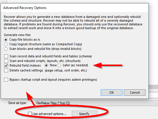

The advanced recovery options allow you to rebuild all field indexes, which is what you did on one field when you followed Lee's directions. You could test that.

@Lee Smith I'm not sure; I'd like to know if it did, though. For the record, here's what I was referring to with the recovery option...
