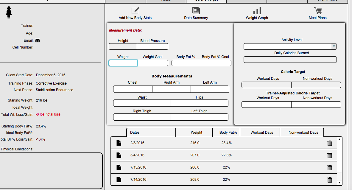

When I click create New Record all fields should be blank.  But my Portal, which has fields inside, pulls data from a different record.  I am not sure why it is doing this but since it is a New Record all the fields in the Portal should be empty.  Please any advice is appreciated.

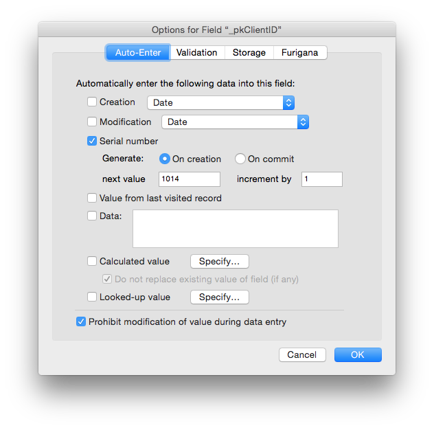

Big problem with the client ID: 34 duplicate records.
Next value for client ID: 1014

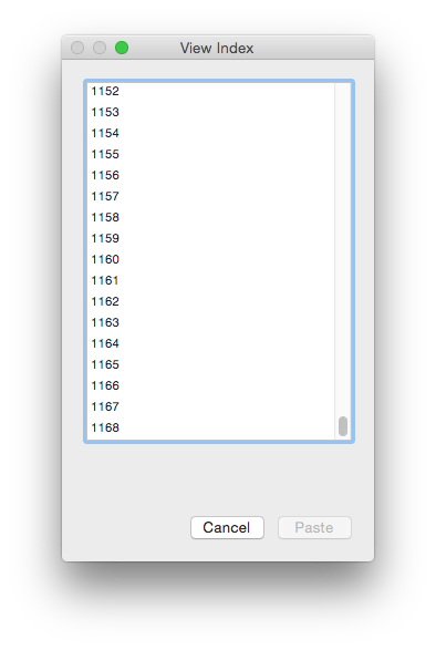

Max existing client ID: 1168

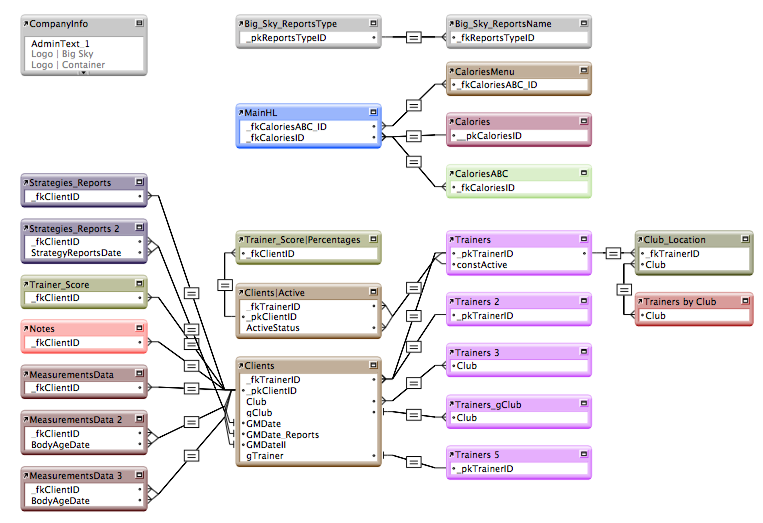

Some graph cleanup.
XFileGraphMod.pdf

50 minutes ago, BruceR said:
Some graph cleanup.
XFileGraphMod.pdf

The smallest and most immediate problem is fixing the next value for pkClientID.
But you now have a lot of records that have duplicate values for the client ID; and THOSE records will have to be fixed.
And they in turn, connect to other records, such as trainer records, and THOSE connections will have to be fixed.
I think you should think strongly about getting a developer to fix this all for you and implement UUIDs, etc.
