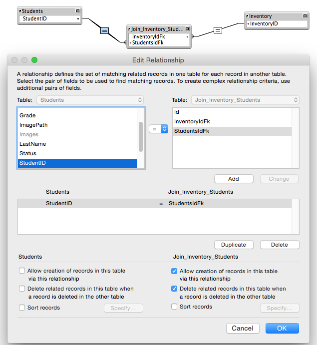

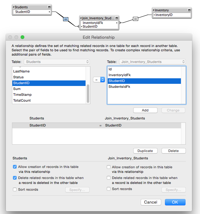

Though a number of issues still remain, it is clear that the original relationship was incorrect.
See attached screenshot of the original and suggested revision.
Thank you for that. I understand what you did. Not getting the inventory to show up under the students table though. I am working on that now.
