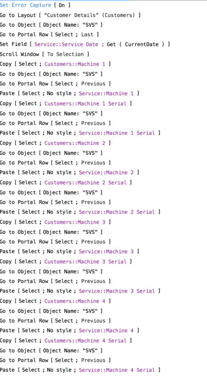

Hi guys you may have done this before but i cant find it so i was wondering if you can help. I wish to create a button that when pressed creates a new record in a portal . I then wanted to go to this new portal line and copy from the same field in the previous line to this new line and so on. I tried this and couldnt get it too work so i did this.
I created fields in the customer layout with the names and serials of the equipment on that site. I then created the script to do a new portal row ( works fine) then copy from the customer field to the new portal row field . Basically im trying to duplicate the record . but with the new date. im probably going about this the wrong way hence my question.
Please ignore the difference with the go to portal row last previous that was me experimenting .

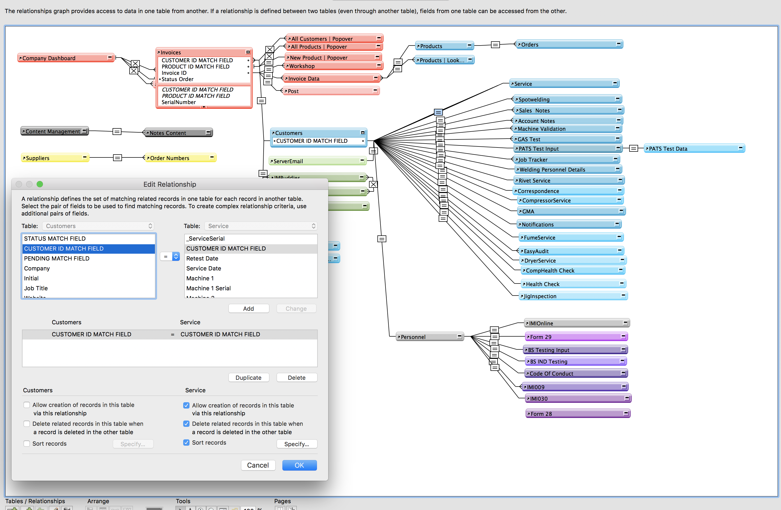

Hello, ok that works perfect but i must have my database setup wrong as it doesnt insert customer ID it starts a blank service but fills in all the data as required .
service is connected by customer id match field . the portal is in the customer layout. Hope that makes sense
How exactly is this field defined (in the Service table)?
