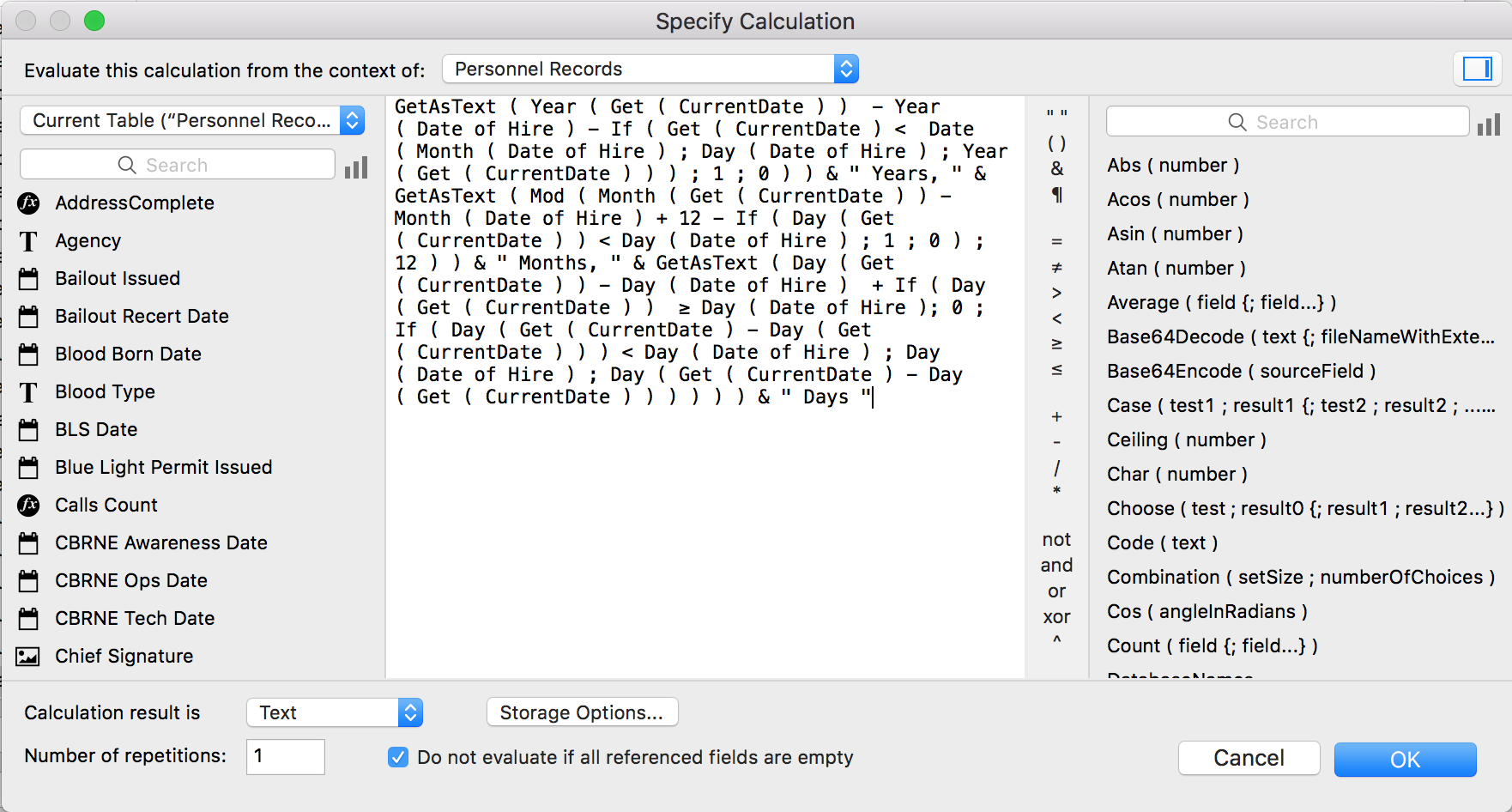

Here is the calculation field I have been using so far and how it is displayed based on the Get Current Date calculation.

6 hours ago, CKonash said:
 Maybe I should just build into the Personnel Records table maybe 5 Start and 5 End dates for a person to take a leave of absence.  I know it isn't very clean
No, it isn't. It would be better to have a related table for the leaves. Or perhaps you should have a related table for the periods of hire (this is assuming these leaves of absences are actually gaps between different periods of hire).
add up the days of leave and then subtract them from the date of hire
You would have to either add them to the date of hire or subtract them from the end date. And since the result is totally divorced from any actual date, you might consider simplifying your calculation to use average year and average month lengths.
