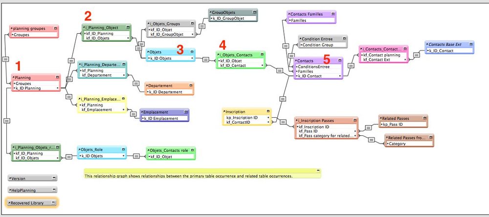

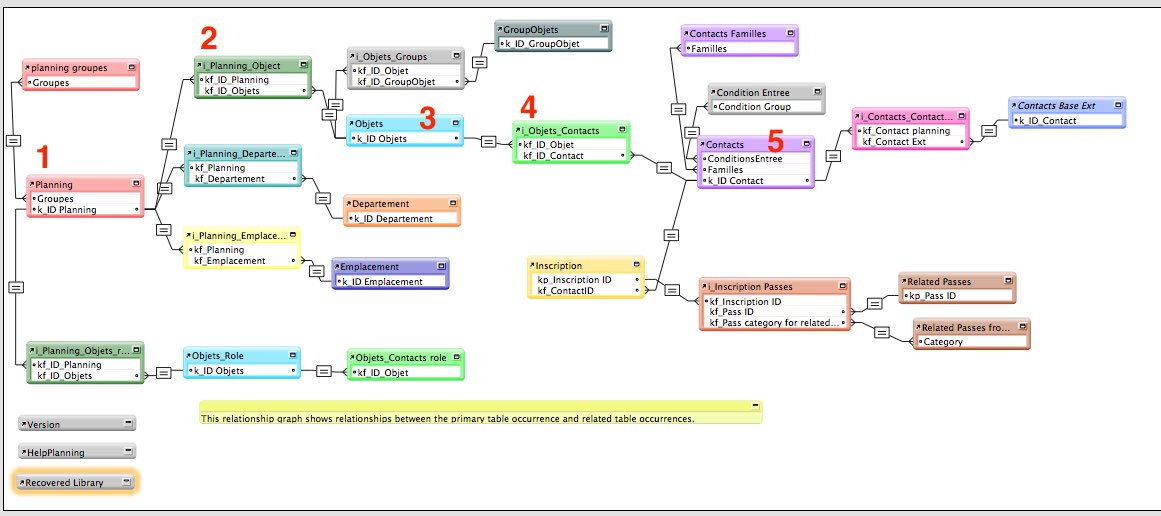

I've a difficult problem.
I have serval linked bases
BASE 1 = Planning (red)
intermediate base Planning_Objects (dark green)
BASE 2 = Objects (blue)
intermediate base Object_Contacts (pale green)
BASE 3 = Contacts (mauve)
The 3 base are linked together as follow:
BASE1 ---> intermediate base (relation = id_planning <> id_objet) ---> BASE2 ---> intermediate base (relation= id_object <> id_contact) ---> BASE3
For some reason i need a field (or to create a record) that unique between base 1 and base 2.
One date = one contact.
How could i do this without changing my structure?
Thanks a lot for helping me if possible.

My database is for an event organisation.
It's has on 3 bases (see image fm3):
  1. Planning
    1. ID_Planning
    2. Date
    3. Hour
    4. ...
  2. Object
    1. ID_Object
    2. a taks
    3. a spectacle
  3. Contact
    1. ID_Contact
    2. name
    3. email
The intermediate bases are linking the bases together by a simple relation.
Intermediate between planning and object will link the ID_Planning with the ID_Object
Intermediate between object and contact will link the ID_Object with the ID_Contact

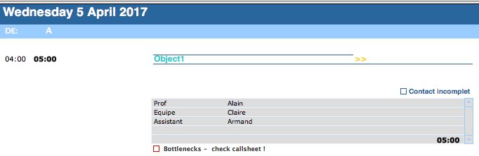

EX.
DATE1 has planned OBJECT1 and OBJECT1 had 3 people attached to it (see image fm1)

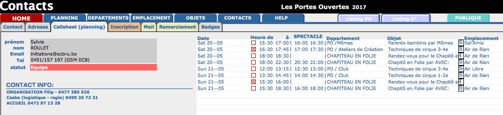

Now what is my problem:
In the planning base i created a field named "Bottleneck".
The purpose is to highlight a Bottleneck in the planning of a person.
I created in the Contact base a portal tool to see all planning per person (see image fm2)
When i highlight the "bottleneck" field (red x) the problem is that it will highlight for every person that is linked to the object and i would like to be able to highlight it for only one person.
