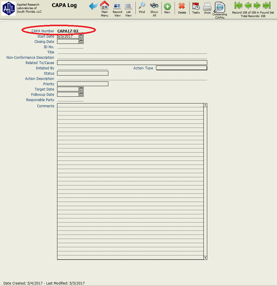

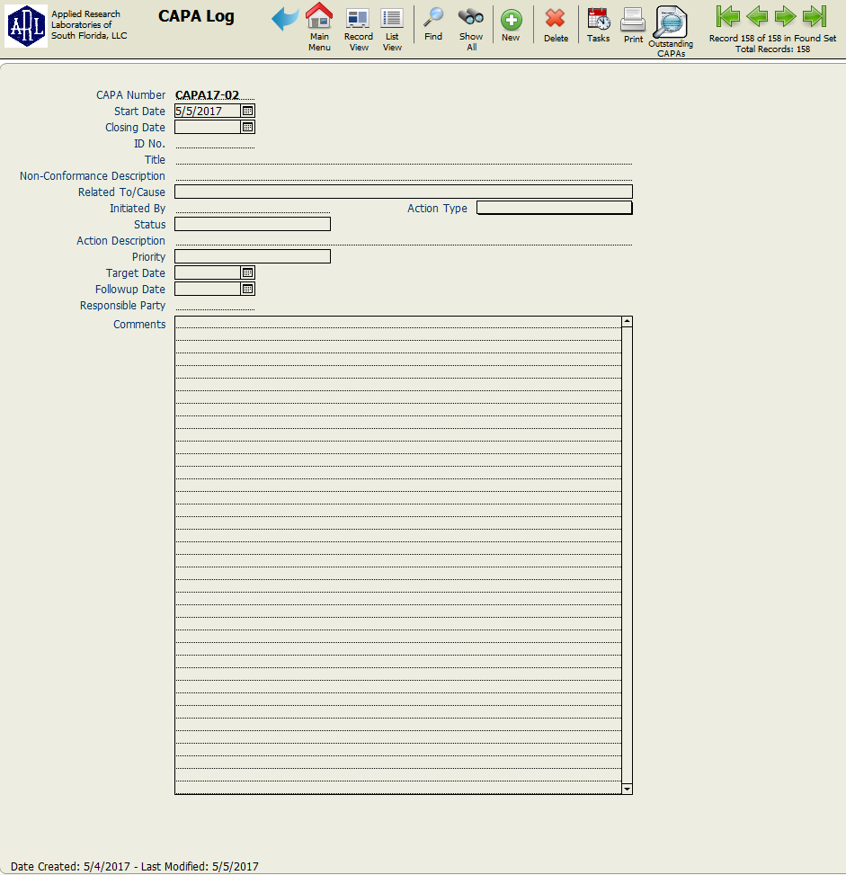

We have a module called "CAPA Log".  In this module users create new records and input text related to those new records.  However, there is one field that is not user generated, "CAPA Number".

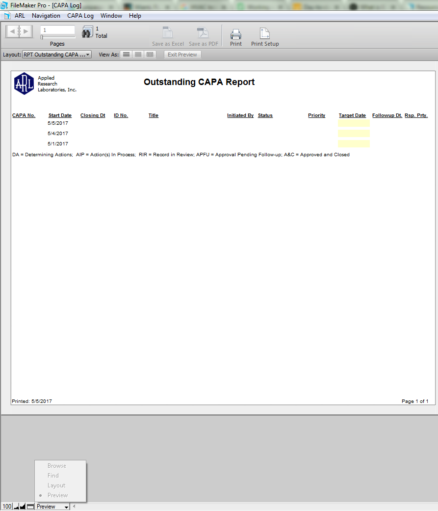

In this module I click on a button titled "Outstanding CAPAs" .  This buttons purpose is to show a list of records that do not have a "Closing Date" entered.  The "Outstanding CAPAs" button performs that function but under the heading of "CAPA Number" there is nothing but blank space.

All records have a "CAPA Number" automatically assigned.590c9de8286a1_Filemaker10.thumb.PNG.959fc7a9a32f8d5ffaffa57eba9d69f3.PNG
If working correctly, when the "Outstanding CAPAs" button is clicked, the "CAPA Number" should be included in the list of records that are generated.

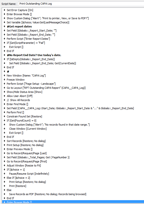

Can you show the report layout in layout mode?   Can you show the script the button calls?  Are you sorting the report by the sub-summary part?
Here is the script the button calls:
The last two lines are cut off, they are "close window" and "exit script"
The report is sorted by date, the most recent record first:

That could be because your script is paused at that time. Let your script finish (or don't run it at all), switch to Layout mode, go to the "RPT Outstanding CAPA Report" layout and examine what - if anything - is under the Capa No. label.

I looked at the layout and that field was referencing something other than CAPA number.  Problem Solved
