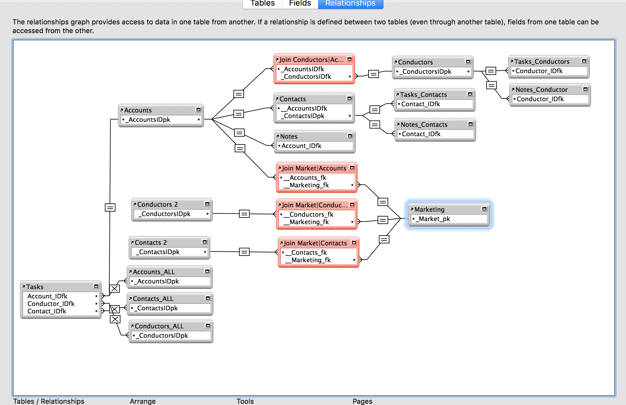

We track a variet of contacts...orchestras, staff and conductors. They all relate to one another (an orchestra can have many conductors, and a conductor can work for many orchestras.) However, we send the same marketing material to all contacts (or selected ones within the groups). Contract A in the example I gave is the orchestra table, Contact B are conductors. I have one event table...1 orchestra table and one conductor table. I want to link 1 event to records in the orchestra table and records in the conductor table. I know I have to do this in two separate actions with two scripts and two join tables. The relationship between the orchestras, join table, and event works fine, but when I try to do the same thing with conductors, a new join table, and the same event table, it doesn't work. It made me create another occurrence of the conductor table before it would let me relate the join table to conductors.
The weird thing (to me) is that it all seems to work perfectly fine...the join records are created properly...but the portal in Contacts B shows ALL the join records...not just the ones related to that contact ID...why is that?
I know you can't tell much from a screen shot...but there it is. I can send the file too but I don't know if anyone wants to dig into that!
To me, that alone would be a sufficient reason to keep all of them in the same table.
I can only guess, as I don't see Contacts B (or, for that matter, Events) in your RG. But I think I can say for certain that a portal to Marketing, placed on a layout of Conductors, will not work as expected. You must place it on a layout showing records from Conductors 2. Or define another relationship, using new TOs of Marketing and the join table, linked to the Conductors TO - and then use a portal to these new TOs. That's what I was trying to say in the last paragraph of my previous post.

Thanks...Sorry about the RG...I have been using different names (such as Contacts B for clarity in describing my situation, the RG is from the actual database.) Yes, this whole structure may be the cause for these difficulties...I originally wanted staff to be part of the orchestra table, but they are independent, move around, have all different information and often times get marketed to differently. It probably would not have been a problem to have staff part of the orchestra table...but conductors definitely need their own table. They are very independent, some work for several orchestras, orchestras have many different free lance conductors. However, marketing often goes to orchestras and conductors...the SAME marketing event...such as a mailed postal card or email campaign...will be sent to the general address of the orchestra, as well as to the address (usually home) of a conductor...sometimes a conductor that has no orchestra affiliation. The events are the same..the same card or email, so I want just one Marketing table. An event (a single record) I want linked to many orchestras and/or many conductors. I have a join table between orchestras and marketing, and a different join table between conductors and the SAME marketing table. For reasons beyond my FM acumen, the orchestra/join/marketing system works (using the script Comment so kindly wrote for me). The same modified script does not work with conductors/join/marketing. FM required that I make a TO for Conductors...to relate to the join table. The script DOES work actually...all the join table records are properly created, with all the proper IDs in the proper fields. What doesn't work is the portal in Conductors...it shows ALL the join records, not just the one that is assigned to that conductor's record ID.
Obviously I don't properly understand TO's.
Thanks!
Todd
It can be tricky. In fact, many developers have sort of given up on this and gone back to using version 6 methodology to define relationships - look up the so-called anchor-buoy method. Basically they replicate every relationship for every base table in their solution.
