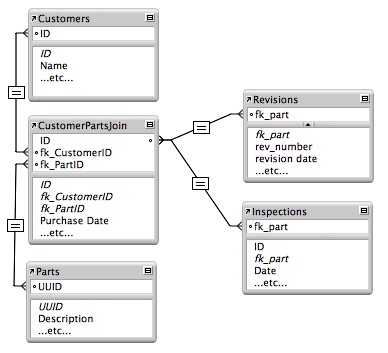

Here is a diagram of the organization of your solution. A layout of the Inspections table can display a field (such as rev_number) in the Revisions table through the chained relationships between the tables (with the intervening CustomerPartsJoin table).  If you put the field in a portal, you can view more than one record, but in this case, you only need to see one record. A portal is not required. Sorting the relationship as mentioned before will cause only the latest record to be that one record.
Note that if you someday want to view a report of all the revisions of a part, all you need to do is add a relationship between Parts and a new TO of Revisions.

Okay this looks like exactly what I need. Thank you very much, you are a life saver! I'm just wondering though, how does the CustomerPartsJoin table know which parts go with which customers? Will I have to manually enter the foreign keys for each on that Table?

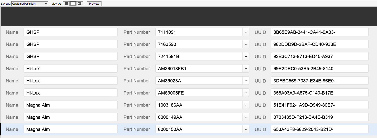

This is the List View of the CustomerPartsJoin table. I have hidden the Customer UUID selector behind the Customer Name box. I can freely chose customers and part numbers here.

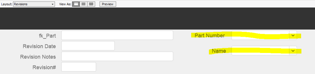

This is the form view for the Revisions table. I have tried all sorts of combinations for the drop down menus. I've tried pointing them to the CustomerPartJoin table, pointing them to their own original Parts/Customer tables, pointing them at the UUID of the CustomerPartJoin table. All to no avail. I'm thinking that I'm just missing something very obvious as I'm still new to FileMaker. Or maybe it's not possible to do what I'm trying to do with the current relationship setup.
