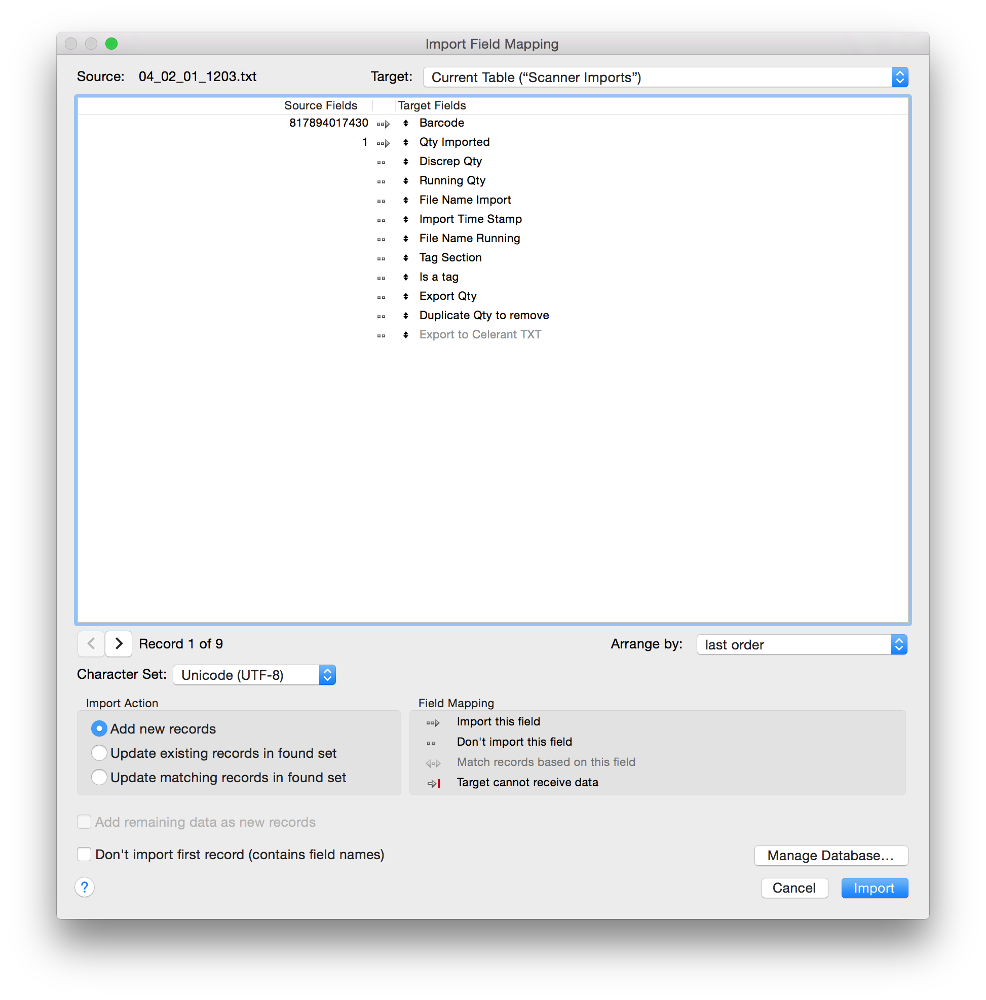

Picture of import attached. In a perfect world, the file name would also import but I may have to update that later with a variable, that will be ok.

Looking back at your 1st post, your import dialogue looked right - you had it set to create new records from each line.
Is that what you want to happen? What if one number has come up previously; do you want to create a new record or update the previous one?
