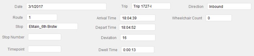

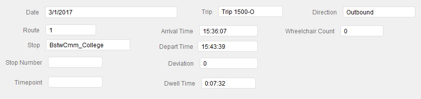

Below is the data that is imported. It does not have the Stop Number or whether it is a timepoint or not. My goal is to have the Stop Number and whether it is a timepoint or not to be displayed also. In each record the stop may be different.
Capture.jpg.ce1746b99957a681870ddd6d8978ab24.jpgCapture2.jpg.c37169ffd411ff5e8afc4f5d09dc271c.jpg

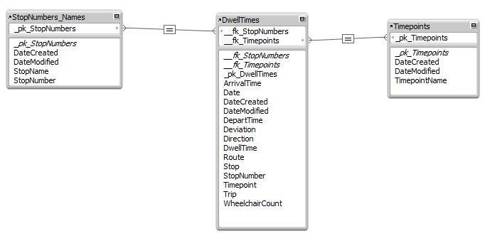

Below is how I have things related.
I don't think you need two tables for the stops.  One table would do.  The 'timepoint' or 'stop' is just an attribute of a stop.  That way you need only to make relationship to the one stop names table and read whether it is a stop or a timepoint.
I am afraid this is not getting any clearer. I suspect your relationships are not set up correctly. Going by your original description, I would expect a relationship based on matching:
DwellTimes::Stop = StopNumbers_Names::StopName
You show a relationship based on matching primary and foreign keys - but you don't say how you populated them (if at all).
