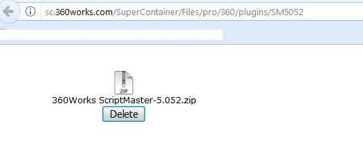

With that being said, I believe the issues you are seeing is because the JRE that is getting downloaded is 64-bit. To remedy this,  please download this build of ScriptMaster and install it.

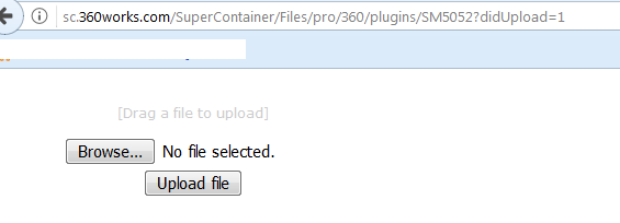

I get this wanting me to delete the file ... not download.
EDIT  :  OOPS ..... stupid me never thought about clicking on the file !! Now I can't get the file to reappear .....
Then it just wants me to upload ..........

Next, download this file and extract it.
SAME issue as above without the "Delete." I just get the 2nd image .......
