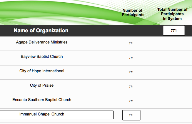

What is occurring now is that I'm getting duplicates from the total amount of records in the system into the field that should display individual amount of data for that church. I used the  Get(TotalRecordCount)  which for the total records in the system and used  Get(TotalRecordCount) for the individual church.
I created a script as such:
Show All Records
Sort Records [No dialog]
Go to Layout ["Participants Count"]
Sort Records by Field [Ascending;BP Count::Created By]
Everything is working correctly but the individual counts is off. Any idea of what I should be doing to make that right?

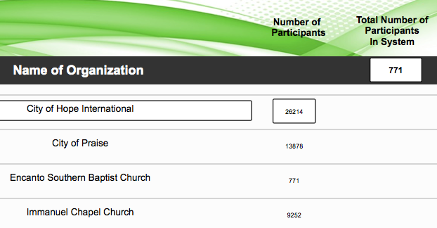

Good afternoon Lee and Steve,
Have changed the programming up a little, think I'm getting closer to getting it working. The numbers are appearing but not sure what these numbers are as they are not correct, but think I'm getting closer to making it work correctly.

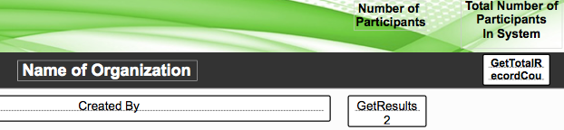

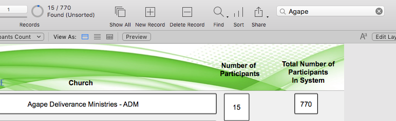

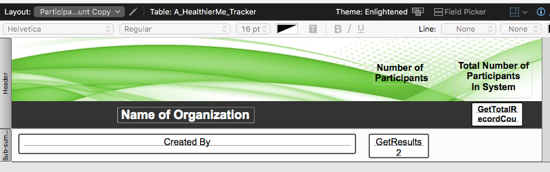

I'm not permitted to send the file as it's part of a churches data and for HIPPA compliancy that would cause me major issues. I feel I'm close to solving it, just need a little help figuring out where I'm going wrong on the counting. I know that if I set it up in the body of layout and do a simple search everything works correctly. It's just when I do it in summary report things break.
The second image shows the working version in it's layout within a body.
The first image shows the summary report layout in layout mode, using the method from the link above.
Better copy of layout mode
