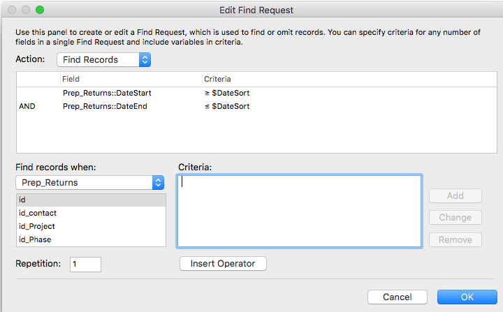

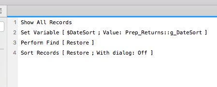

I could use some help with a find function.  I have a table with fields  for DateStart and DateEnd for each record.  I have been unsuccessful in getting a Find to work when I have a single global date field and then a Find script.  I when I enter a date into the global field and then use the find methods below I am not returning the records that fall in between those dates, it looks like I am returning the records that start and end on the date of the global date field?
This seems like a simple idea but I can't figure out how to find records between dates based on a single field find script.
  5a0f6dc520187_ScreenShot2017-11-17at6_12_39PM.png.6cd855e931c6ba66e25eb6614c8d4b49.png5a0f6dc48c228_ScreenShot2017-11-17at6_12_56PM.png.29ed16e897387d9e819ef56c53adb850.png
Your operators are reversed.
Prep_Returns::DateStart ≤ $DateSort
Prep_Returns::DateEnd ≥ $DateSort
BTW, the Show All Records step is redundant. Perform Find automatically searches the entire table. And you don't need to put the Prep_Returns::g_DateSort field into a variable. You can use it directly in the Find criteria.
