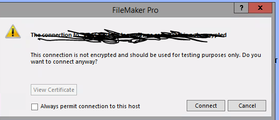

Just recently i have installed fielmaker 16 server and deployed all files on it. Now users are connecting it through citrix but we are getting 1 pop up which always show while you open application . It says "Your connection is not encrypted and shows 2 options of "Connect" and "Cancel". we have to connect option everytime while connecting and opening files. Earlier in 14 we was not getting such issues.
DO you have solution to resolve this issue. i am attaching that error message. Please help me out. pls see attachment.

Alternatively, tick the box "always permit connection" and it won't appear on that workstation any more. It'll need to be done once on every FileMaker client.
