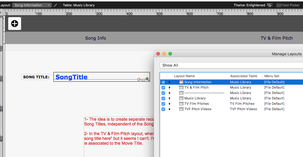

Your addition works brilliantly! Thanks again! :)  My solution is much broader and contains more layouts than you're seeing. There are now 2 different layouts, exactly like the TV & Film Pitch, so therefore the scripts, etc, are identical with the exception for certain name changes. Because of these 2 layouts, the Set Variable, like in the image below, the Value: "" was changed to Value: 1. For some reason, when I added your code to both of my layouts, when I would go to one of the layouts, click on the top title field, then go to the other layout, the top title wasn't highlighted. Adding Value: 1 did the trick. I hope this is ok, overall.
Lastly, when I go between records on either layouts, the top title isn't highlighted anymore. Is this also part of the "Go to Layout..." script?

Do you want it to always highlight the top title when you move to those layouts? You need to write out what you want it to do when you go to the layout. Then write the script to match that.
If you do want the 2 layouts to highlight the top title every time you go to those layouts, then you don't need the variable at all. Just perform the script without the If..End If. And without the variable. You haven't been clear about exactly what you want to happen, so I'm guessing a little.
