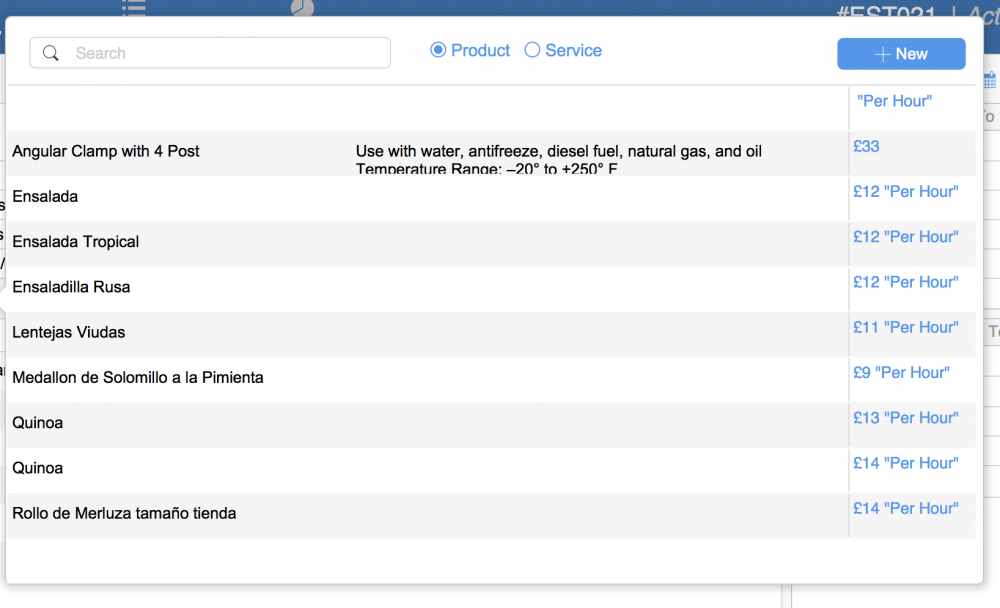

Very recently downloaded FMSP and having fun customising it. I'm a rank amateur at this and normally enjoy solving the problems the customisation process throws up but there is one thing I can't figure out and would love a steer on...
When making an estimate, I press the button "Add Line" and a popup appears with my products on it. However, the ones I inputted are connected with "Per Hour" rate but the default rccconsulting pre-inputted product (Angular Clamp) does not have this association.
How can I lose the "per hour" association and have it just like the pre-inputted product?

hi
The "per hour" part is the field " price label" which isn't on the product Detail layout
Just add the "price label" field to the layout to change manually or you can change the auto entry setting which is set to "Per Hour"
