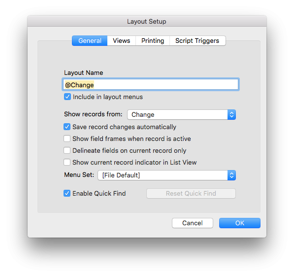

 - also do one more thing...
Set the Layout setup to this as well.
Delineate Field frames will cause with sliding and your field borders from displaying.
User error! lol
