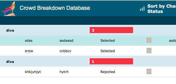

So if i understand, you want to know how many Diva are rejected, are selected and display it in list mode after sort ?
you could use a statistic field with count the id
Something like that ?795019359_Capturedecran2018-08-29a15_10_20.png.226bfeb5342da7b41bb0186df45344ed.png

no problem, everyone have start one day.
so you make a report by grouping on character and status.
so it will counting how many line you have for each couple of character / status.
have a try with this file see FMFORUMS_Count field in the database
Character_database.fmp12
amazing.. I see now.. thank you....
