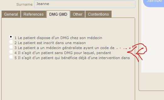

I have a topic that can take the chosen value in a vertical radio buttons list.
But some values in this list have a description so long that it can not be displayed on one line. So I need a "return to line" in the list of radio buttons. (see attached photo)
How to do ?
Thank you for your wise advice.
V!ncent

Filemaker doesn't reflow the text for radio buttons when there's too much. One way to work around that is to have a radio button with just values of 1,2,3 and 4, set the linespacing to double or triple (or whatever works) and add individual text fields with the content, which will wrap.
Hello Olger,
I had thought of this solution, but it does not suit me because the values are taken in a table and can change. So I will have to opt for a different presentation than radio buttons (the problem is that I must stay in the look of existing administrative documents).
Thank you for your good suggestion.
