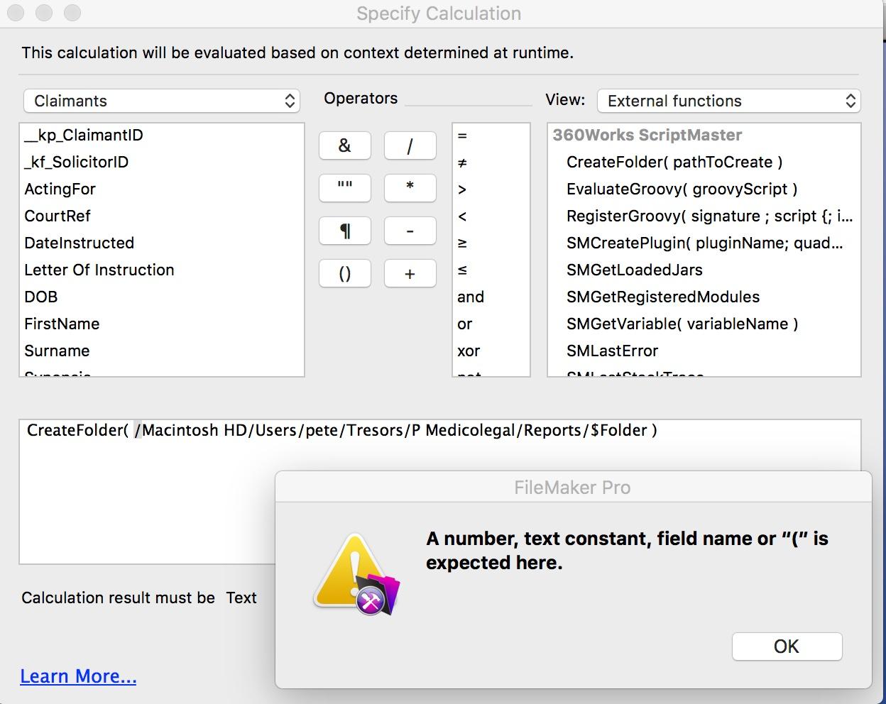

Thanks. I tried that but got a syntax error - see pic
When you use literal text, you need to enclose it in quotes.
So something along the lines of:
CreateFolder ("/Macintosh HD/Users/pete/Tresors/P Medicolegal/Reports/" & $Folder )
Assuming that $Folder is the variable where you store the folder name.

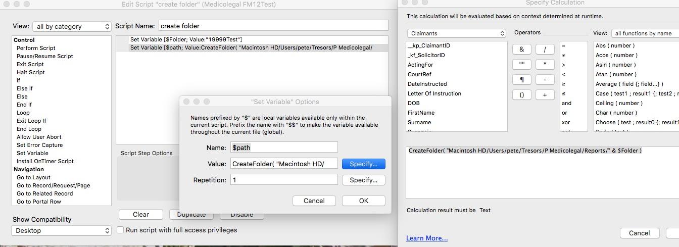

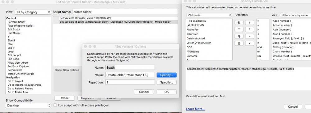

Thanks so much. That has got rid of the syntax error. However the script seem to do anything, no error message.
Is the 'set variable' command enough? Or does it need anything else. According to Scriptmaster it will return 1 or 0 depending on whether the folder already exists (it doesn't). see pic.
P

sorry, attached now as jpeg
Update: the function has returned zero, which means it thinks the folder already exists
Edited by Pete
Your parameter is missing a slash before Macintosh HD.

Thanks. I changed it to "/Macintosh HD...", but it returned an error. Then I used "filemac:/Macintosh HD...." and it returned 1, which means it was successfully created. But still no folder (anywhere on the hard drive).
I'm using FMP 12 Advanced. It might be time to upgrade...
this won't work with a path that starts filemac:
It needs to be an O/S system path, and while I know its not that helpful, works here (although I might have tweaked my version of the function a bit)
