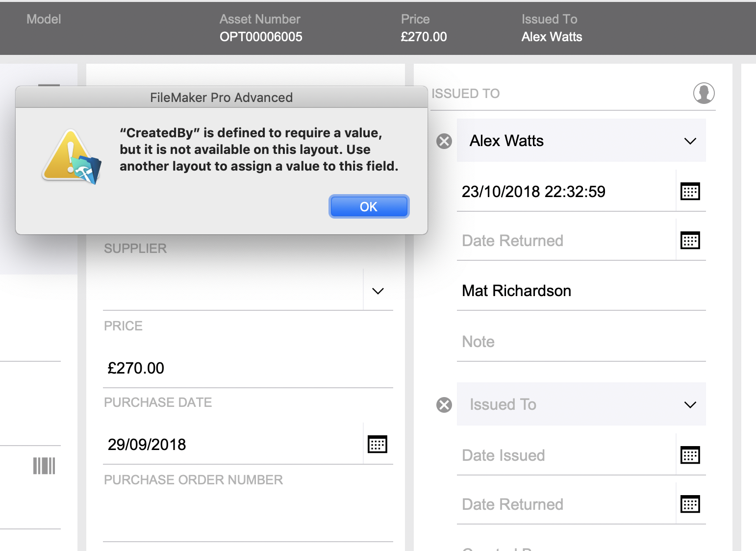

I am hoping for some guidance from those far more knowledgable than I. I am new to filemaker, using the Asset template, adding some extra fields and making it work for me, unfortunately, there is an error with "CreatedBy is defined to require a value, but it is not available on this layout" as the pop up.
I have worked out I need to have a box, linked to createdby, I am logged in, when I complete the process of assigning an asset to an individual, the createdby linked box inserts my name automatically, then when I try to click off or to a new asset entry, the warning comes up.
I am on mac, Mojave, if that makes any difference. I have validation on "not empty" which it isn't, as my name is auto populated, so not sure how else to sort this out. Any advice would be appreciated, aware this may be a little vague, I'm new at this so let me know what extra you need to see.

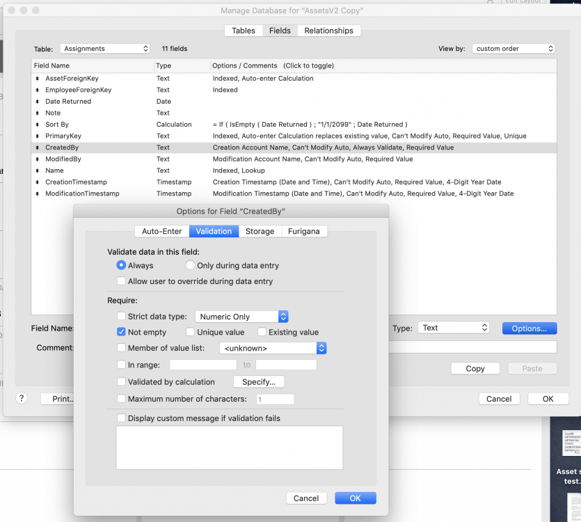

Did you check Manage->Security->Privilege set that you actually have permissions to write to that field? Does it work when you remove the restrictions? Ie, untick 'not empty', 'prohibit modification'?

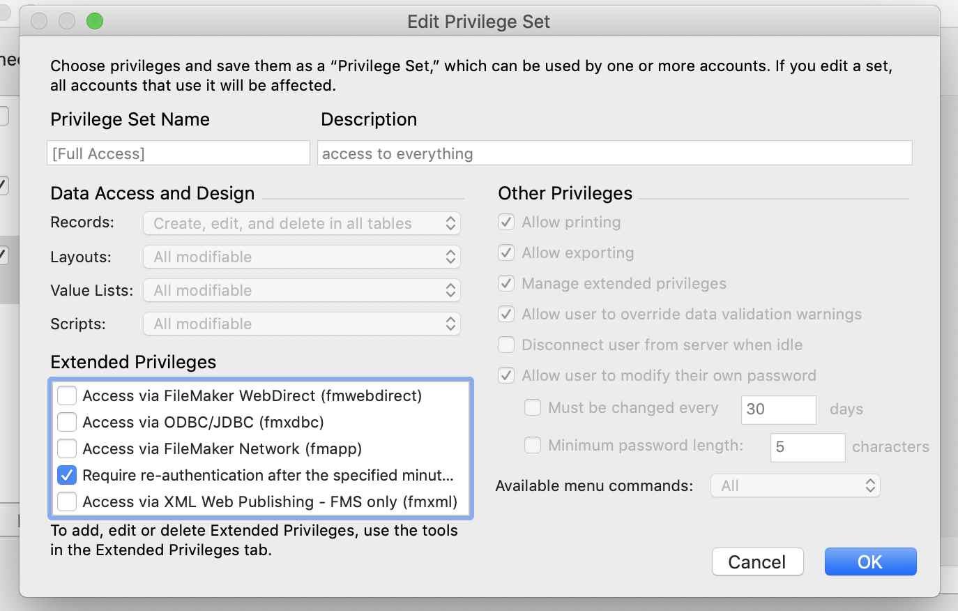

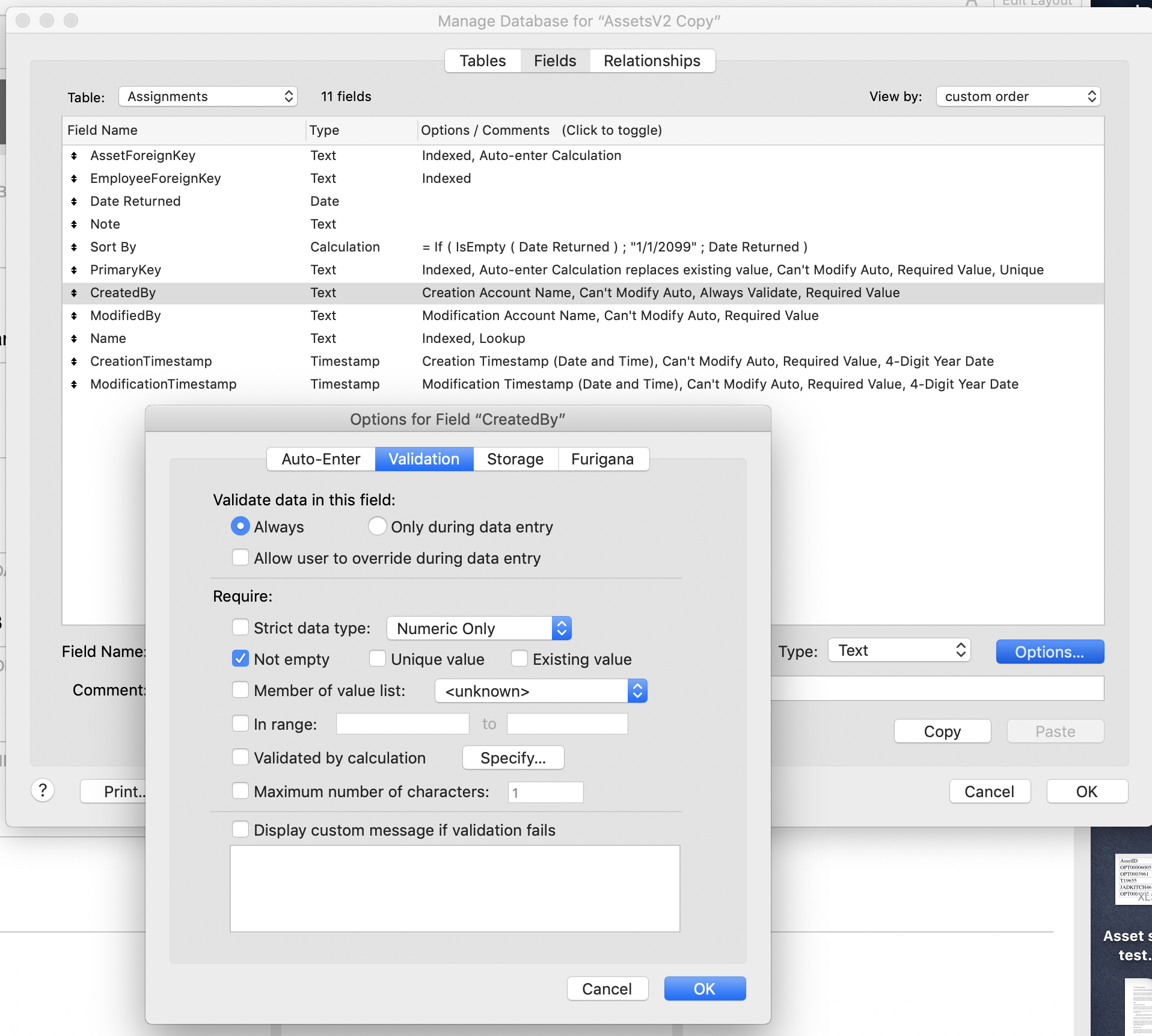

Hi, thanks for answering! I checked both of those options, it didn't change anything when I unticked the "not empty" box within the Assignments table, same error. So I unticked it in all 4 of the tables, Assignments, Vendors, Employees, Assets, still no change, same error. I checked the privilege set, I have full access to everything, so I don't think it's that.

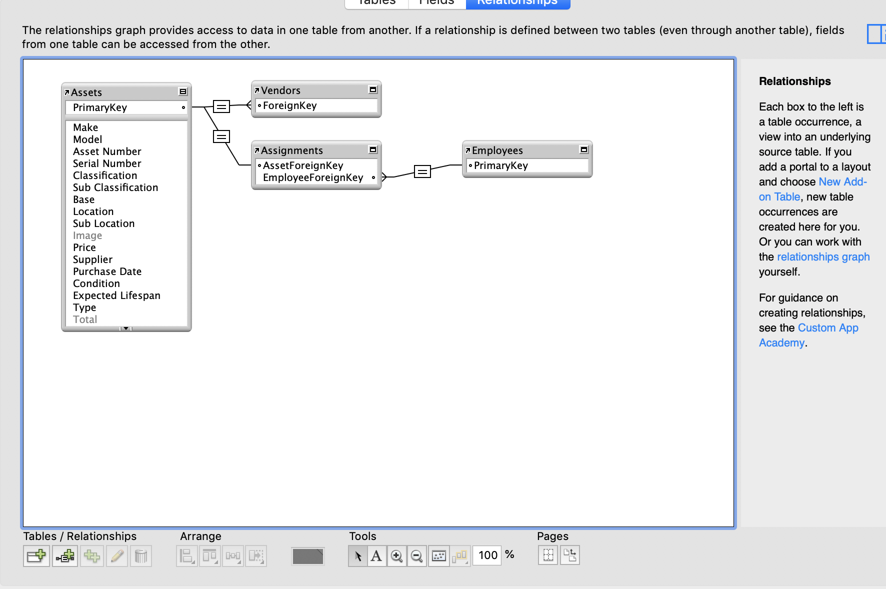

Strangely, it is auto populating the CreatedBy field I have put on the page, it does this for my name when set to that, I can also log in as Admin, it populates then too with Admin, but still has the same error. I started a new database with the same template, made no changes other than to add a random name, a random asset, assign the asset to that name and the same error comes up, so I don't think it is something I have changed or removed, it's something I'm not doing. Added the relationships as well in case that shows anything, I haven't changed them from the original template though.

I just made a copy of the database, then tried removing createdby from each of the tables, thinking maybe I could remove the problem by not having a record of who created the entry, just leaving the time and date with the creationtimestamp, now when I click somewhere within the record, it says creationtimestamp is defined to require a value, same issue even though the time and date have been automatically entered, so I think I have bigger issues than just removing the requirement for my name to be assigned to the action of creating the entry.

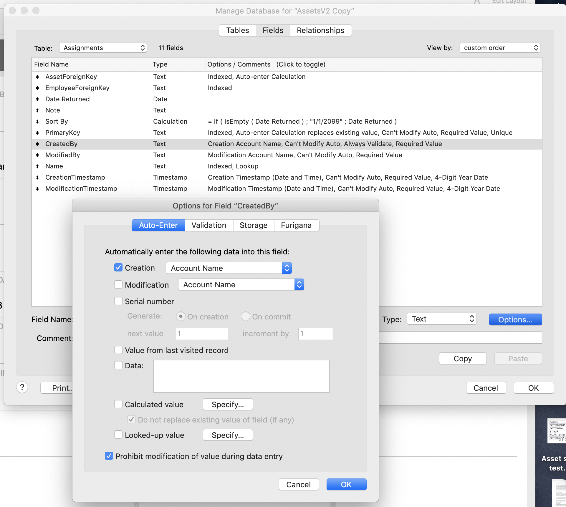

When you import, you should see the option to "Perform auto-enter options while importing" in the Import Options dialog. If you don't, then the target table does not have any fields that auto-enter values (and that could be a hint as to what the real problem here is).
46 minutes ago, mjrp said:
as they are autofill boxes, I can't edit them
It's not because they are auto-entered fields per se - it's because you have also checked the "Prohibit modification of value during data entry" option. And you still can modify them using a script.
