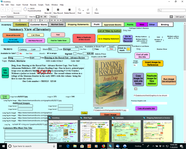

Hello Comment,  Thank you for your comments on my problems with this script issue.  Before going further on the actual script I have to say that setting up a relationship between the files of Inventory and Web pages is not possible.  One book in Inventory can have several different scripts in Web pages which access it.  For example: a book by Robert Frost is accessed by the script for the individual page for Robert Frost as well as a more general page for books of poetry.

Yes, occasionally I have given thought to the idea of merging some of my 11 separate files, but let me give you all some insight into why that hasn't happened.  I started using FileMaker many years ago starting out with FMP 5.  Prior to leaning about FM I had experience with DB2 and another program the name of which I have forgotten.  It took me 14 months to create a very thorough, relational book database for my books, my customers, market data and shipping statements/invoice files.  They were all separate, but related files.  Through the years I have added more related files to keep track of profit, monthly profit, customer credit card data, book appraisals, and most recently bookbinding projects/billing.  Once cell phones became ubiquitous I started to imagine the day I would be able to load parts of my database on to my iPhone so that I would have some critical information available to me when I was in the field.  Once FileMaker Go appeared I knew that my dreaming would become reality.  But to put all the multiple files covering things like profit, credit card data, bookbinding, etc. on the iPhone would only clog up FileMaker Go with unnecessary stuff.  So, I felt that keeping them separate would allow for both a piecemeal download to FM Go and also keep the credit card file separate for security purposes.
At this point I consider my scripting problem solved.  The workaround that I came up with may not be the most efficient in terms of scripting, but it works.  And going back to the idea of consolidating files I am stopped by considering the old adage - "If it isn't broken, don't fix it."
I will be the first to admit that one of my current minor complaints about having migrated to FM 17 Advanced from FMP 13 is that each of my separate files when opened requires that it be closed before I can quit the entire book database.  Previously under FMP 13 I could close the open open file and all files would close with it.  A picture attached below might help to explain what happens now.
