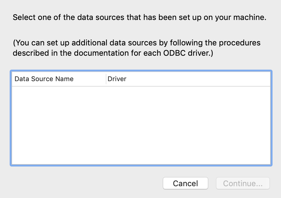

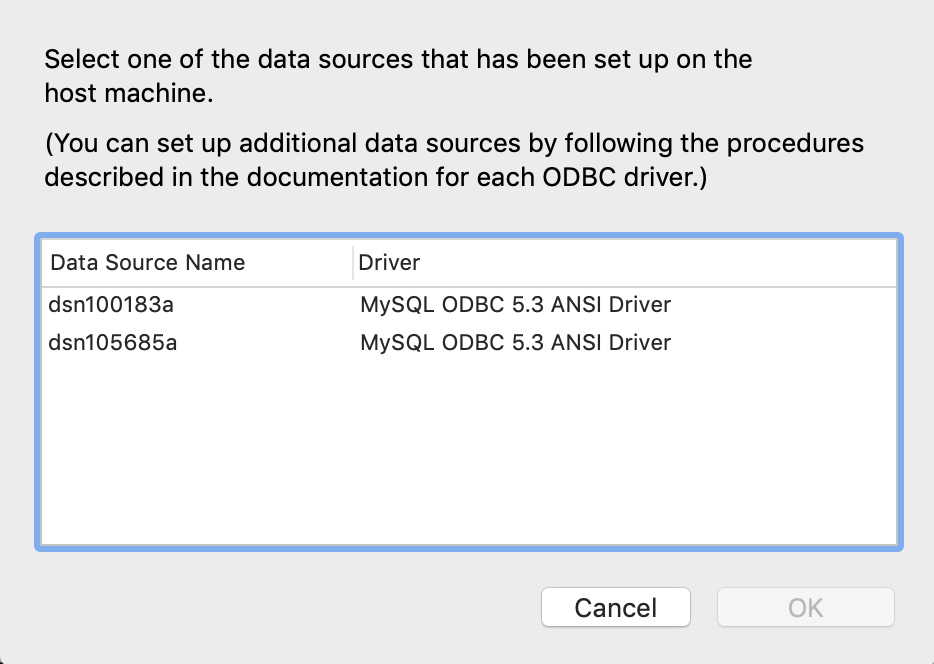

February 17, 20197 yr Author It looks like I will be allowed to INSERT via ODBC but for some strange reason when I select the "Execute SQL" script step my OBDC drivers are not available ? Yet they're available via the relationship graph but not within the script step? Confused ? Suggestions ? Relationship Graph: Execute SQL script step: Edited February 17, 20197 yr by "... you mean these fans?"
