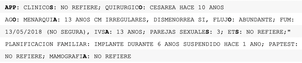

Basically, I would like to style certain words or phrases in a text field.  I want to style whole words only. Selecting the phrase by adding delimiters (space, comma, dot, semicolon, apostrophe, etc) is simple and works fine.
The problem is isolating single letter words followed by a colon, such as:
S:
O:
A:
P:
Because TextStyleAdd doesn't search for whole words, I end up with words ending in S:  O:  A:  P: also being styled (See attached file).
So, the script should do something like:
If there is a whole word, formed by a single letter (any of these four letters S, O, A or P), at the beginning of the field, followed by a colon, make it Bold
Hope this helps.
